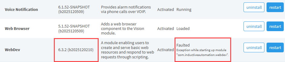

Module Shows as Faulted After Installation​
In some cases, a module may appear to install successfully, but its functionality does not become available. A common cause of this behavior is a version mismatch between the installed module and the Ignition platform. For a module to load correctly, the middle digit of the module version must match the middle digit of the Ignition platform version. If a version mismatch is detected, the module will display a State of Faulted: Exception while starting up module on the Module Configuration page.
To verify compatibility, navigate to Status > Overview and note the Ignition version currently running on your Gateway.

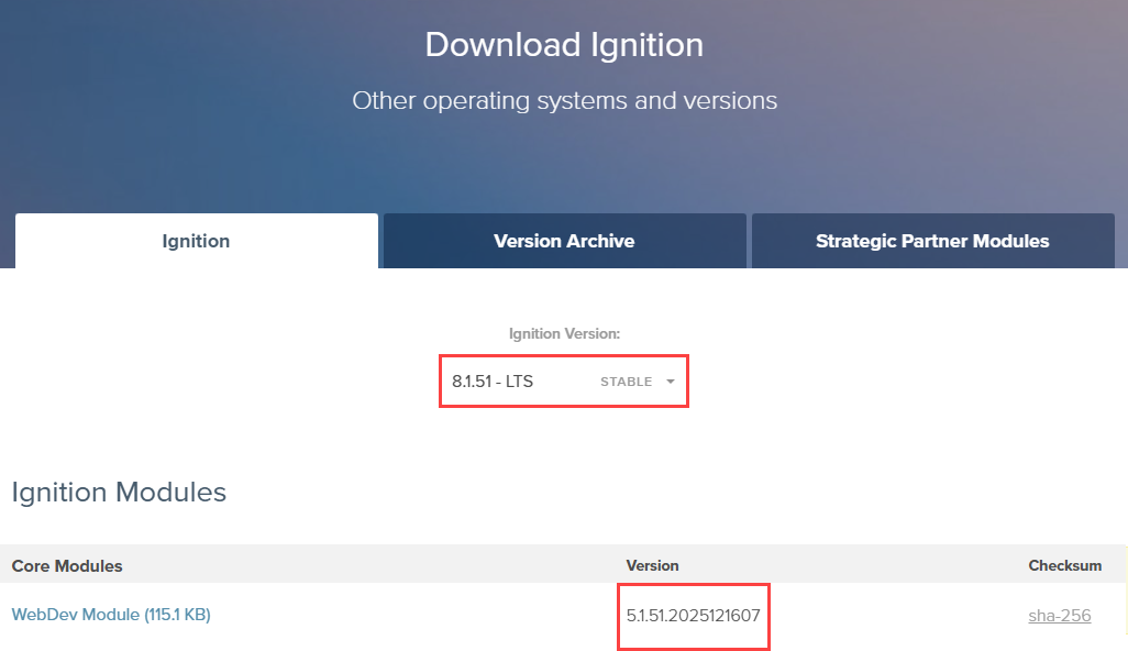

Because the WebDev module shown above has 3 as the middle digit and the Gateway has 1, there is a version mismatch and the module will remain in a faulted state. To resolve this, download the correct version of the module from the Inductive Automation Downloads page. Use the Ignition Version dropdown or Version Archive tab to select the Ignition version that matches your Gateway. From the list of available modules, locate the compatible version and download it.

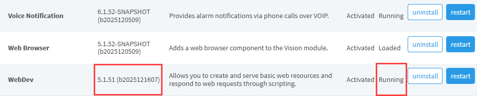

After installing the compatible version, the module will show a State of Running, and will become available for use.
