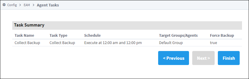

  4. Select task and then click Next. The Task scheduling screen is displayed. Tasks can then be scheduled to run in a few different ways depending on your needs. In the example below, the task is set to execute twice per day.
    Changed in 8.1.17
    Cron Expressions starting with the "/", "-", or "," characters are no longer considered valid.
  5. Click Next. The EAM wizard will guide you through setting up your task.
  6. Lastly, a Task Summary window appears. If you're ready to go, click Finish. Your task will be submitted according to the schedule type you defined.
