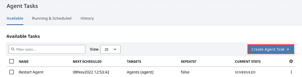

  1. To create an Agent Task, go to the controller Gateway, and select Network on the Gateway Webpage.
  2. Select Enterprise > Agent Tasks. This opens the Agent Tasks page.
  3. Click Create Agent Task +.

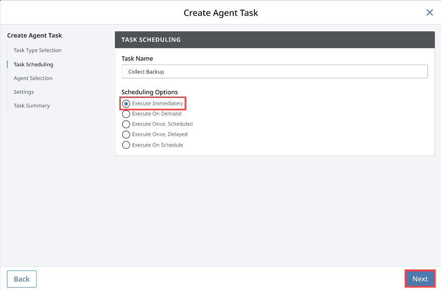

  4. Select task and then click Next. The Task Scheduling form is displayed. Tasks can be scheduled to run in a few different ways depending on your needs. In the example below, the task is set to execute immediately.
  5. Click Next to finish creating your task with the Agent Selection and Settings forms.

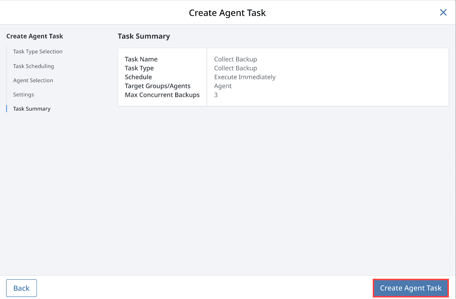

  6. Review your settings on the Task Summary form. If you're ready to go, click Create Agent Task. Your task will be submitted according to the schedule type you defined.

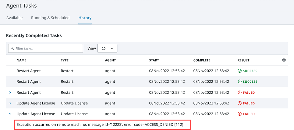

Agent Task Status​
You can utilize the Running & Schedule and History tabs to gain more insight to the Agent Task Status beyond what is shown on the Available tab. Any Agent Tasks that encountered an error will be listed on the History tab with a dropdown that displays the log message.

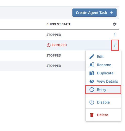

Should a task fail, you can directly execute the task again without needing to set the task back up by using the Retry option.
  1. On the Gateway webpage, navigate to Network > Enterprise > Agent Tasks.
  2. Expand the three dots menu for the task you want to retry, and select Retry.
  3. The Gateway will ask for a confirmation. Click Confirm.
The controller will now attempt to run the task again.
