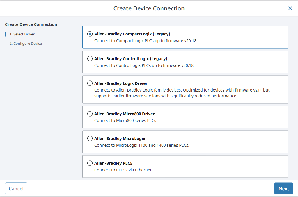

To connect to a supported device:
  1. Go to Connections > Devices > Connections on the Gateway.
  2. Click Create Device Connection.
  3. Choose a driver from the list of available drivers.
  4. Fill in the connection details like IP address or slot number.
  5. Click Create Device Connection to finish configuration.
Once connected, your device appears on the Connections page with its current status.

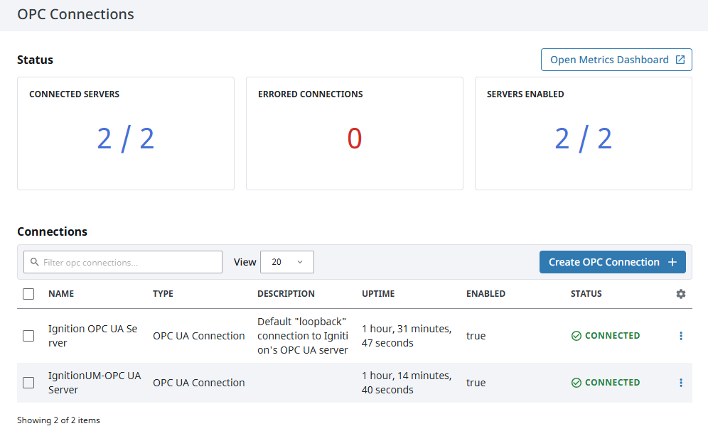

  1. Go to Connections > OPC > Connections.
  2. Click Create OPC Connection.
  3. Enter the server endpoint, security settings, and other details.
  4. Test the connection and save.
See the OPC UA Client Connection Settings for more information.

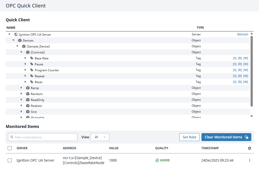

OPC Quick Client​
Once you have a device connected, you can use the OPC Quick Client to browse the OPC UA server and verify live values directly from the Gateway at Connections > OPC > Quick Client. This provides a simple way to validate device connections and inspect data without creating tags or opening the Designer.
The page displays a tree view of the Ignition OPC UA Server, including connected devices and their exposed nodes. Expand the tree to browse available objects and tags. Nodes display action indicators that reflect their capabilities. [R] indicates read access, [W] indicates write access, and [S] indicates that the node can be subscribed to. Clicking [S] creates a subscription for the selected node and adds it to the Monitored Items table at the bottom of the page, where live values, quality, and timestamps are displayed.
You can select one or more monitored items and click Set Rate to adjust the polling rate in milliseconds. Use Clear Monitored Items to remove all active subscriptions, or the three dots menu on a row to remove individual items.

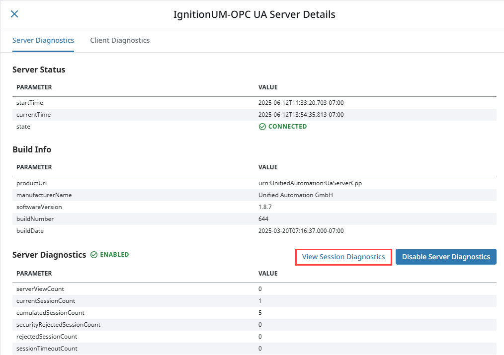

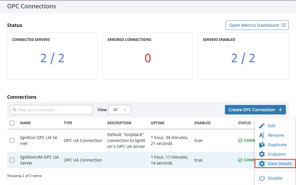

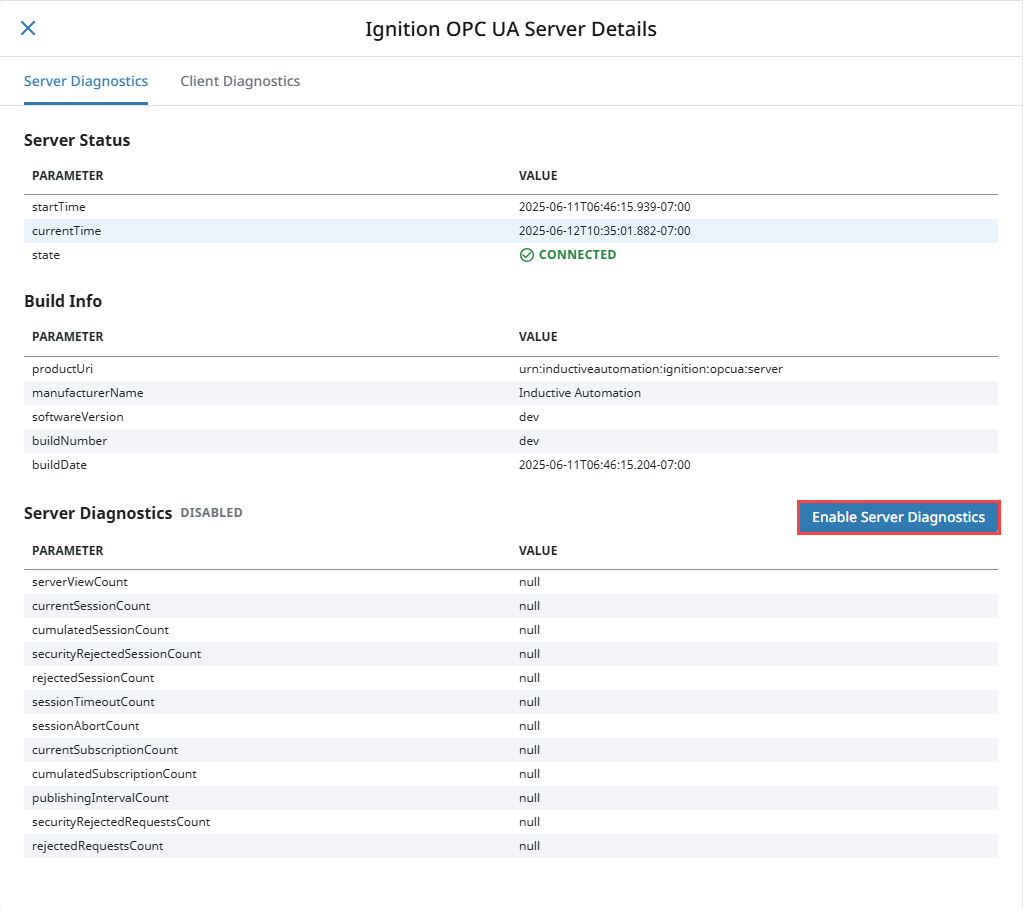

To view server metrics:
  1. Click the three dots menu next to the connection and select View Details.
  2. Use the Server Diagnostics tab on the Details panel to view server status, build info, and server diagnostics.
  3. Click Enable Server Diagnostics if you want to begin tracking session diagnostics. A View Session Diagnostics option will appear.
  4. Click View Session Diagnostics to inspect session and subscription activity.

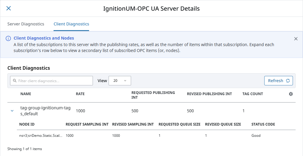

To monitor subscriptions and diagnostics:
  2. Click the three dots menu next to the connection and select View Details.
  3. Use the Client Diagnostics tab on the Details panel to view subscription groups, publishing intervals, and item statuses.
  1. Expand a group to see the monitored node details, including:
    • Node ID
    • Sampling intervals
    • Queue sizes
    • Status code

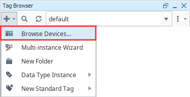

  1. Launch the Designer and open your project.
  2. From the Tag Browser, click the plus icon and select Browse Devices.

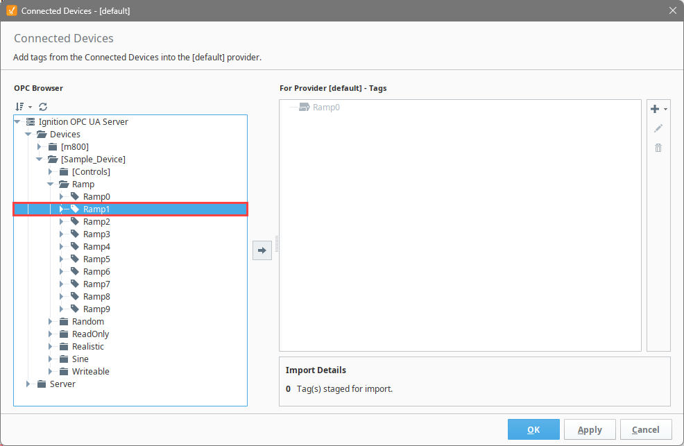

  1. On the Connected Devices popup, navigate the OPC Browser on the left to find a live data point from your device.

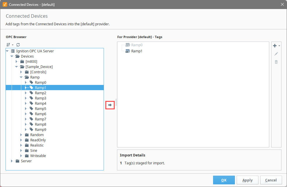

  1. Select any number of tags and click the arrow to stage them for import.
  1. Click OK to update the Tag Browser with the imported tags.
The tag appears in your Tag Browser and begins updating in real time. This means Ignition has subscribed to the data point and is now receiving updates from the device on a regular interval, based on the tag group configuration.
