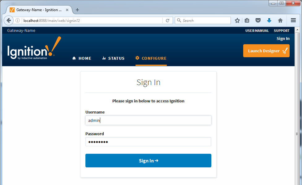

  1. From the Gateway Webpage, navigate to the Configure section.
  2. Enter the default username and password for the Designer and click Login.
    Username: admin
    Password: password

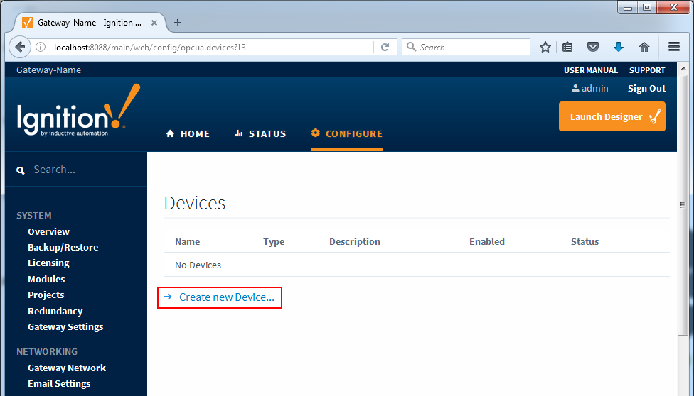

  3. Scroll down to the OPC-UA section on the left and click the Devices link.
  4. To add a new Device Connection, click the Create new Device... link.
  5. Select Simulators Generic Simulator and click Next.
  6. Give the new connection a name and click Create New Device.
