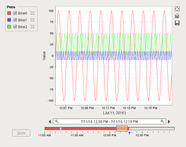

Historian Charts​
Creating charts to display historical data or realtime data is a snap! The Easy Chart component allows you to make powerful, runtime-configurable time series charts from the Tag Historian data. Simply drag and drop history-enable tags onto a chart a chart to create chart pens and data trends. Your charts and graphs can include subplots, axes, digital offsets, and a moving average pen. You can quickly and easily turn your historical and realtime data into dynamic charts and graphs for your users.
To see all the chart options and features, refer to the section on Using the Easy Chart.
Standard Easy Chart

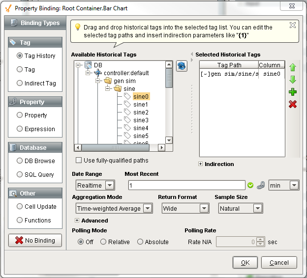

Tag Historian Querying​
While the data is stored openly in the database, the format does not lend itself well to direct querying. Instead, Ignition offers a range of built-in querying options that are very powerful and flexible. In addition to the simple on-change querying, the system can perform advanced functions such as querying many tags from multiple providers, calculating their quality, interpolating their values, and coordinating their timestamps to provide fixed resolution returns.
Querying can be performed on tables and charts through the Historical Binding, and through scripting. You can also query tags from the Reporting Module.
Tag history binding
