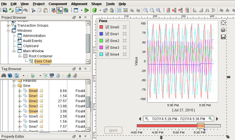

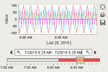

Historical​
This mode places a date range selector at the bottom of the chart. This mode allows users to select a start and end date for the trends. The data density is shown at the bottom of the chart: the more vibrant the color, the higher the density. This the default mode, and commonly used in situations where users need to look at specific date ranges. It is important to remember that the chart does not poll in this mode. New values are only added to the chart when the selection box is moved or re-sized.

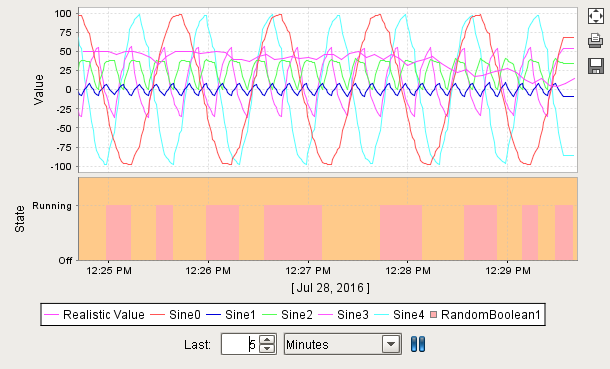

Realtime​
Displays the most recent data for each pen. Users are able determine how far back in time the trend should display with the spinner and drop down at the bottom of the chart. In this mode, the chart polls for data at the rate specified by the Poll Rate property.
In some cases, you may notice that the most recent values on tag pens tend to flat-line, and then 'snap' to a different value. This is generally due to how often the chart polls versus how often history is being generated. If the chart polls at a 1,000ms rate, but history is only recorded at a 10,000ms rate, then the chart will extrapolate the last recorded value for 9,000ms. After a new value is recorded, the next poll will return the latest value, and the flat-line will change position.

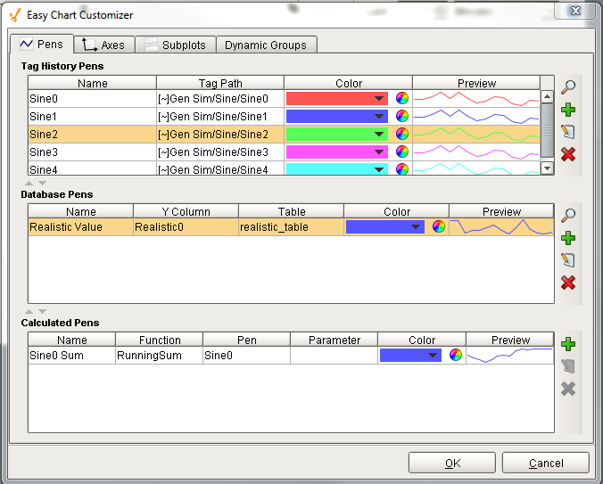

Pens on the chart, or each series of data points on the chart, can be customized to take on a number of different styles and colors. There are three types of pens, and each pen functions in a similar manner. What makes them different is how their data is collected.
  • Tag Pens - These pens are driven by the tag history system. Data from any historical provider can be used, and tag history from different databases can be shown on the same chart. These are the type of pens that are created when tags are dragged onto the chart. Since the Tag History system is being used, an Aggregation Mode must be selected, and the Tag Path needs to be specified for each pen.
  • Database Pens - These pens are driven by a SQL query, so they are ideal to use when trending Transaction Group data. However they can query for data in any connected SQL database, so it is possible to show historical data recorded by other systems on the Easy Chart.
  • Calculated Pens - Pens that derive their data from calculations performed on other pens. Data for calculated pens is not stored directly into a database, but rather calculated in the runtime based on data from another pen. These type of pens are great for display running totals, control limits, or specification limits.
Pens can be added manually to the chart with the Easy Chart Customizer, or dynamically by modifying the various pens properties listed under Chart Configuration on the chart. These properties contain the configuration of each type of pen, and can make use of the binding system. Because of this, pen preferences can be saved to a database table, and then queried in the runtime with a SQL binding. Additional adjustments can be made with Cell Update Bindings or scripting to create a dynamic-yet-robust chart.
Easy Chart Customizer​
Aside from the properties on the component, the Easy Chart has its own Customizer that allows modifications to be made to the chart. Aside from configuring pens, the customizer can be used to create subplots and new axes. Once created, each pen can be assigned to any available axes or subplots. This way different values can be shown on different plots, with an axis that is specific to data at hand.
