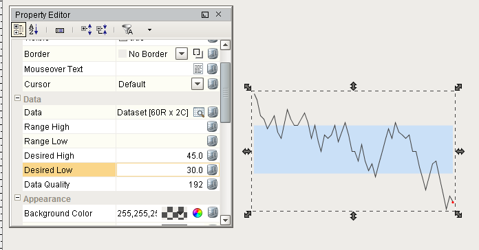

The trend on the Sparkline Chart is determined by the Data property located in the Property Editor. Bind the Data property to either a Tag Historian realtime query, or to a database query. The dataset should contain two columns: the first being a date, and the second a number/value.
Any additional columns in the dataset are ignored. Thus, the Sparkline Chart will only show a single pen per instance of the component. The data should be sorted by date in ascending order.
The red dot on the Sparkline Chart represents the most recent value. The Sparkline Chart can display a band of color across the back of the chart which indicates the desired operating range of the datapoint. Setpoints can be displayed on the chart by setting a value for the Desired High and Desired Low properties. This allows an easy way to view when the value fell out of bounds. Both properties must have a value for the Desired Range Color to appear.
