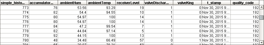

Historical Data Logging​
Logging data for historical analysis, either through Tags Historian or with the SQL Bridge module, requires a database connection. Databases are great at handling historical data, and by using a standard relational database your data is stored in an open format that can be used in many ways.

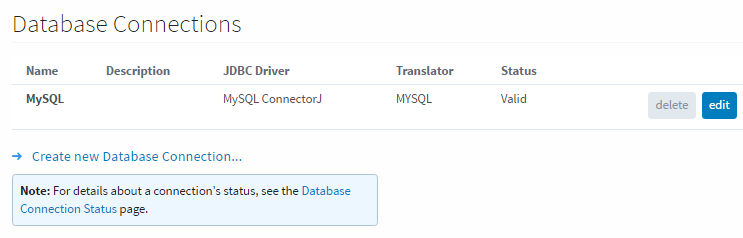

Installing and Connecting to a Database​
Once you've identified a server, all you need to do is create a connection to that server to get up and running. See the Installing Databases and Connecting to Databases sections for details about how to install and connect to different databases through Ignition.
If we don't already have a connector for your database type, you can simply add it in yourself.

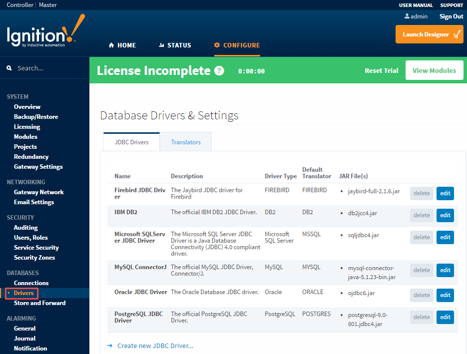

Database Drivers and Translators​
What is JDBC?​
JDBC stands for the Java DataBase Connectivity API. It is a standardized way for Java-based applications to interact with a wide range of databases and data sources. A JDBC Driver enables Ignition to connect to, and use data from, a particular database system.
JDBC in Ignition​
Ignition, being a Java-based application, leverages JDBC in order to connect to a variety of data sources. This enables Ignition to offer a standardized set of functionality on a wide range of different systems and databases. This includes not only commonly-used databases such as MySQL, Microsoft SQL Server, and Oracle, but additionally other lesser-known systems as well, provided the manufacturer offers a JDBC driver for the system.
JDBC vs. ODBC​
JDBC differs from ODBC (Microsoft's OpenDataBase Connectivity standard) primarily in the fact that JDBC is written in Java, and thus can be used without modification in cross-platform environments. Additionally, whereas ODBC is a complex standard that is becoming technically out-dated, JDBC is a modern, clean specification for cross-vendor database access.
Can I Connect Using ODBC?​
While it is indeed possible to connect to an ODBC data source using the JDBC-ODBC bridge, this is generally not advised. The bridge is designed to offer a minimal amount of functionality, and is considered a "transitional solution", meaning that it should only be used when JDBC is not available. In other words, if a JDBC option is available, ODBC should not be used.
Since most commercial databases offer JDBC drivers, transition is usually as simple as recreating your database connections inside of Ignition. The lack of a JDBC connection inside of Ignition does not necessarily indicate that JDBC isn't available for your particular database. Licensing restrictions sometime prevent the inclusion of drivers with 3rd-party software. Therefore, before using ODBC, due diligence should be taken to verify that no JDBC solution is available.

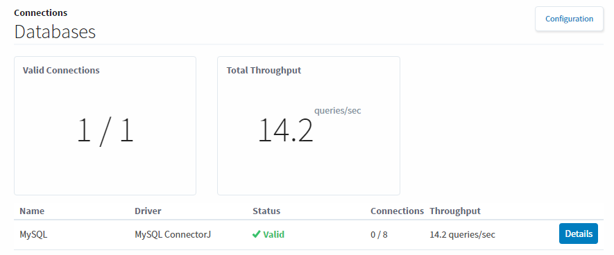

Monitoring Connection Status​
The state or status of a database can be monitored from the Status section of the Gateway, under Connections > Databases. The status panels show the current state and a fault message, if applicable, or throughput statistics if the connection is active.
When a connection is not available, it is re-tested every 10 seconds, and the status is updated.
