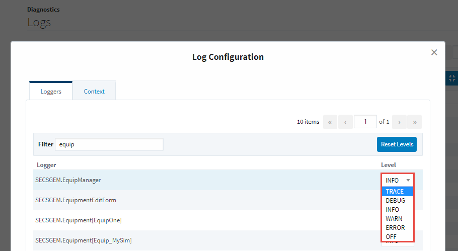

Logging​
Each Equipment Connection has a logger associated with it. The Equipment Connection loggers and their severity level can be seen in the Status section of the Gateway webpage under Diagnostics > Logs. By default, only messages with a severity level of INFO or more severe such as WARNING or ERROR are logged. A lot of data about what an Equipment Connection is doing can be logged by changing the log level of the Equipment Connection to a less severe level. At the TRACE log level, all SECS messages sent and received by an Equipment Connection are logged.
To change the severity level of a logger, click the Settings " " button to open the Log Configuration window. Locate the logger you want change, and click on the dropdown arrow on the right side of the window, and select the severity you want to update.
Wrapper.log File​
Messages and log events can be viewed from Ignition's log file called "wrapper.log" as well as the Status section of the Gateway webpage under Diagnostic > Logs. If something is not working as expected, it can be very useful to turn on ALL logging for an Equipment Connection and view the wrapper.log file. Often an exception error or log message will explain what is happening.
