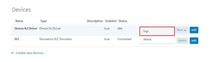

 - On the Devices page, click the Tags link next to the newly created device. The Manage Tags page is displayed, allowing you to configure which variables in the device will show up as Tags in Ignition.

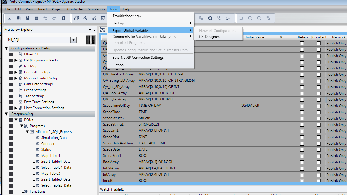

Exporting from the Device
To export variables from Sysmac Studio, navigate to the global variables and select Tools > Export Global Variables > CX-Designer.
The variables will be saved to the clipboard in tab-separated format. You can now paste the contents into an empty text file for use with importing into the Ignition Gateway.

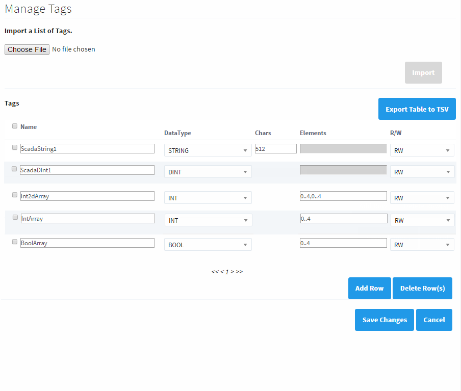

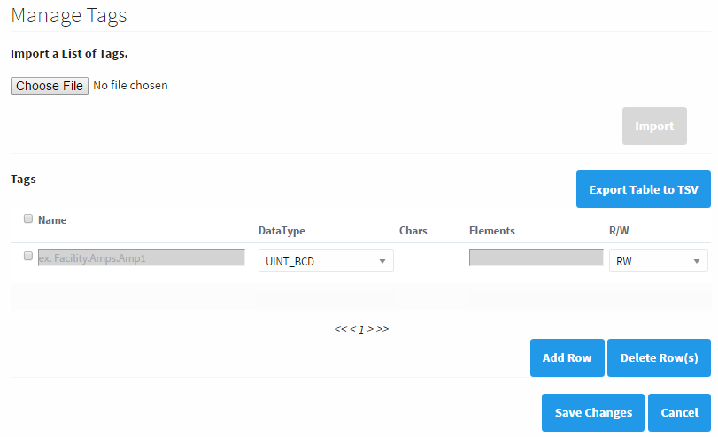

In order to browse Tags in the Designer, you must first create a mapping for the device in the Gateway. The Manage Tags page can be accessed by navigating to the Omron device and clicking the Tags link.
Importing Tags
Once on the Manage Tags page, you can manually enter the Tags, or import them from a tab-separated file. When importing, first choose a file, then click the Import button. The default option when importing is to replace the Tags table with Tags from the import. Select the append option to append Tags to the table.
Once you save any changes made to the Tag mapping, you can view the Tags in the Designer OPC Browser.

In the Tags table of the Manage Tags page, we have four columns of configuration per Tag:
- Name - The corresponding address of the variable found in the Omron device. Struct members are separated with periods.
 - Datatype - The datatype of the variable found in the Omron device.
 - Chars - The maximum number of characters that a String Tag will contain.
 - Elements - Denotes whether the Tag is considered a scalar or array. See below for more detail on specifying the number of elements to read from the device.
 - R/W - Specifies read / write access permissions on the Tag.
Scalars
Leaving the Elements column blank will result in a scalar Tag.  When reading from the device, only one element will be requested.
Arrays
Specify the number of elements in an array in the form of 0..N. The initial index 0 is always included, so an array mapped with 0..4 elements is a 5 element array.
The number range specified in the Elements field can deviate from the range specified in the device's program. Thus, if an array was configured with a range of 0 - 4, but the mapping on the Ignition Gateway is set to 3 - 7, then the resulting items would be offset as follows:
