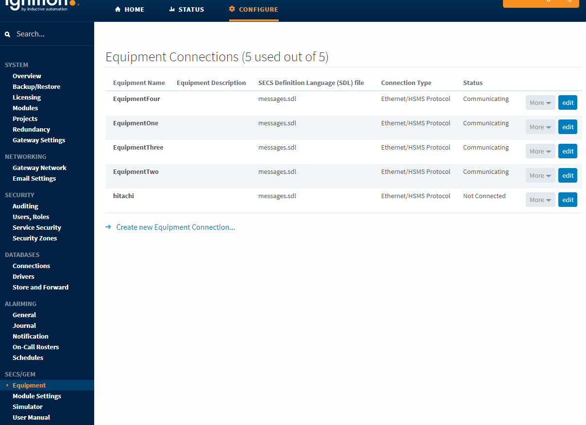

The module will add a new header to the Configure section of the Gateway Webpage that allow you to configure connections to the equipment, or setup simulators that are used for testing.
Equipment Connections
The equipment connections are what allow Ignition to communicate with the specialized semiconductor fab equipment. Equipment connections are setup within the Configure section of the Gateway Webpage. Connections can be made over Ethernet using TCP/IP (HSMS protocol) or over a direct serial connection (SECS-I protocol) using a RS-232 cable. Note, that the direct serial connection requires that the equipment be connected directly to the Ignition Gateway server, and that the Serial Support Gateway Module be installed. The equipment connections also require the use of a database, which will store sent and received messages for audit purposes, and to hold some configuration data. Each equipment connection connects to one tool and one database and transfers SECS messages between the Gateway to the tool. Any number of equipment connections can be configured in the Gateway as long as your license allows it, and different equipment connections can be configured to use the same database connection or different database connections.
