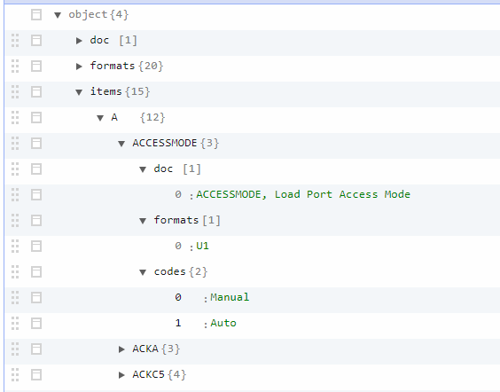

SDL Item Definitions​
The SDL Item Definitions list out all possible items that are used in SECS Message definitions. If a SECS Message attempts to use an item that isn't defined in the SDL file, it will throw an error.
SDL Item Definition Example​
"A":{
"ACKC7":{
"doc":[
"ACKC7, Acknowledge Code"
"formats":[
"B"
"bytes":1,
"codes":{
"0":"Accepted",
"1":"Permission not granted",
"2":"Length error",
"3":"Matrix overflow",
"4":"PPID not found",
"5":"Mode unsupported",
"6":"Command will be performed with completion signaled later",
6,
"Other error"
Each item has a list of properties that define what the item is.

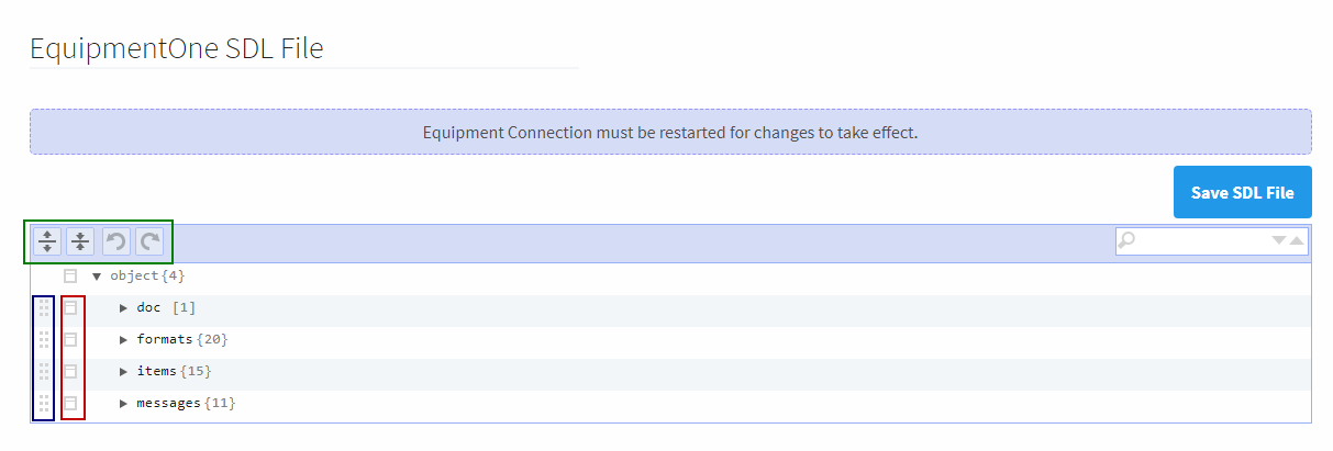

SDL File Editor​
In the Equipment Connections section, you can make edits to the equipment's SDL file right in the Gateway Webpage by clicking the More button and selecting the 'edit sdl file' option.
caution
After editing the SDL File, the equipment connection must be restarted for the changes to take effect.
&quot; &quot;
Once in the SDL file editor, there are a few things that can be done. The six dots to the left &quot; &quot; of each row circled in blue above, allow you to change the order of the rows by clicking and dragging a row and dropping it in a new spot.
The buttons near the top circled in green apply to the document as a whole:
ButtonDescription
&quot; &quot;Expands all nodes.
&quot; &quot;Collapses all nodes.
&quot; &quot;Undo the last edit made to the file.
&quot; &quot;Redo the last Undo.
Finally, the buttons circled in red &quot; &quot; bring up a context menu with a few options that allow you to add and remove rows and change the row type:
&quot; &quot;
OptionDescription
TypeChange the type of the row. Possible options are:
  • Auto - Automatically determines the type based on the value.
  • Array - Contains an ordered collection of values.
  • Object - Contains an unordered set of key/value pairs.
  • String - Determined from the value, but always returned as a string.
SortSorts the rows in either ascending or descending order.
  • Ascending - Sort the children of this array in ascending order.
  • Descending - Sort the children of this array in descending order.
InsertInserts a new row before the selected row. Possible types are:
DuplicateDuplicates the row, including all sub elements
RemoveRemoves the row and all sub elements.
Each row can be drilled into by clicking on the expand arrow to the left of the element, which allows you to see the sub elements. Many times, these sub elements can also be drilled into to find more sub elements. Once you find the element you want to modify, you can simply edit the text to make a change.
&quot; &quot;
Once all the edits are made, clicking the 'Save SDL File' button at the top right of the screen will save your changes. However, the changes won't take effect until the equipment connection is restarted.

"items":{
"A":{
"ACCESSMODE":{
"doc":["ACCESSMODE, Load Port Access Mode"],
"formats":["U1"],
"codes":{
"0":"Manual",
"1":"Auto"}},
