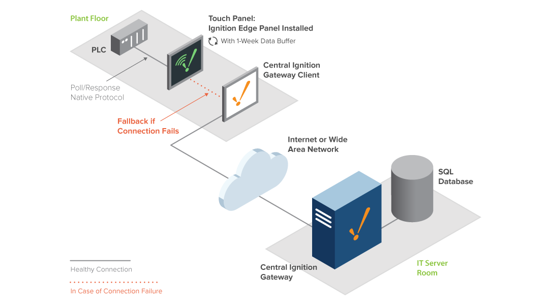

Panel​
Ignition Edge Panel enables edge-of-network-HMI functionality. This includes:
  • One local client
  • One remote client
  • Alarming features, including one-way email notification
Ignition Edge Panel includes one week of data buffering for trending and local client fallback for mission-critical applications.
Edge Panel Diagram

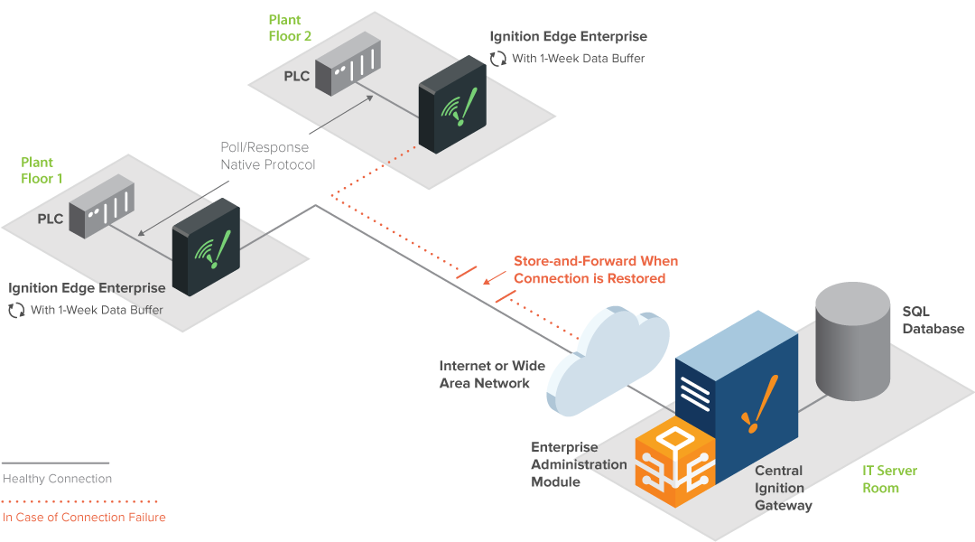

Enterprise​
Ignition Edge Enterprise acts as a limited remote server that synchronizes data from the edge of the network to a central Ignition server. It has Distributed Tags, history, and remote alarming built in. Remote backup, restoration management, and centralized monitoring of performance and health metrics are also available if the Ignition Enterprise Administration Module (EAM) is installed on the central Ignition server. Edge Enterprise comes with up to one week of data buffering so it can be used to store-and-forward your data to a central server in case of network failure.
Edge Enterprise Diagram

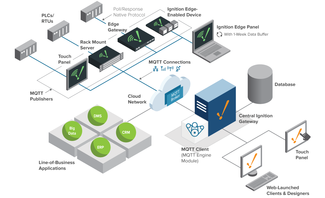

MQTT​
Ignition Edge MQTT by Cirrus Link turns virtually any field device such as a touch panel or a client terminal into a lightweight, MQTT-enabled edge gateway that works seamlessly with Ignition IIoT. Ignition Edge MQTT uses the highly efficient MQTT protocol to transmit data to any MQTT broker and supports the Sparkplug data-encoding specification.
Edge MQTT Diagram

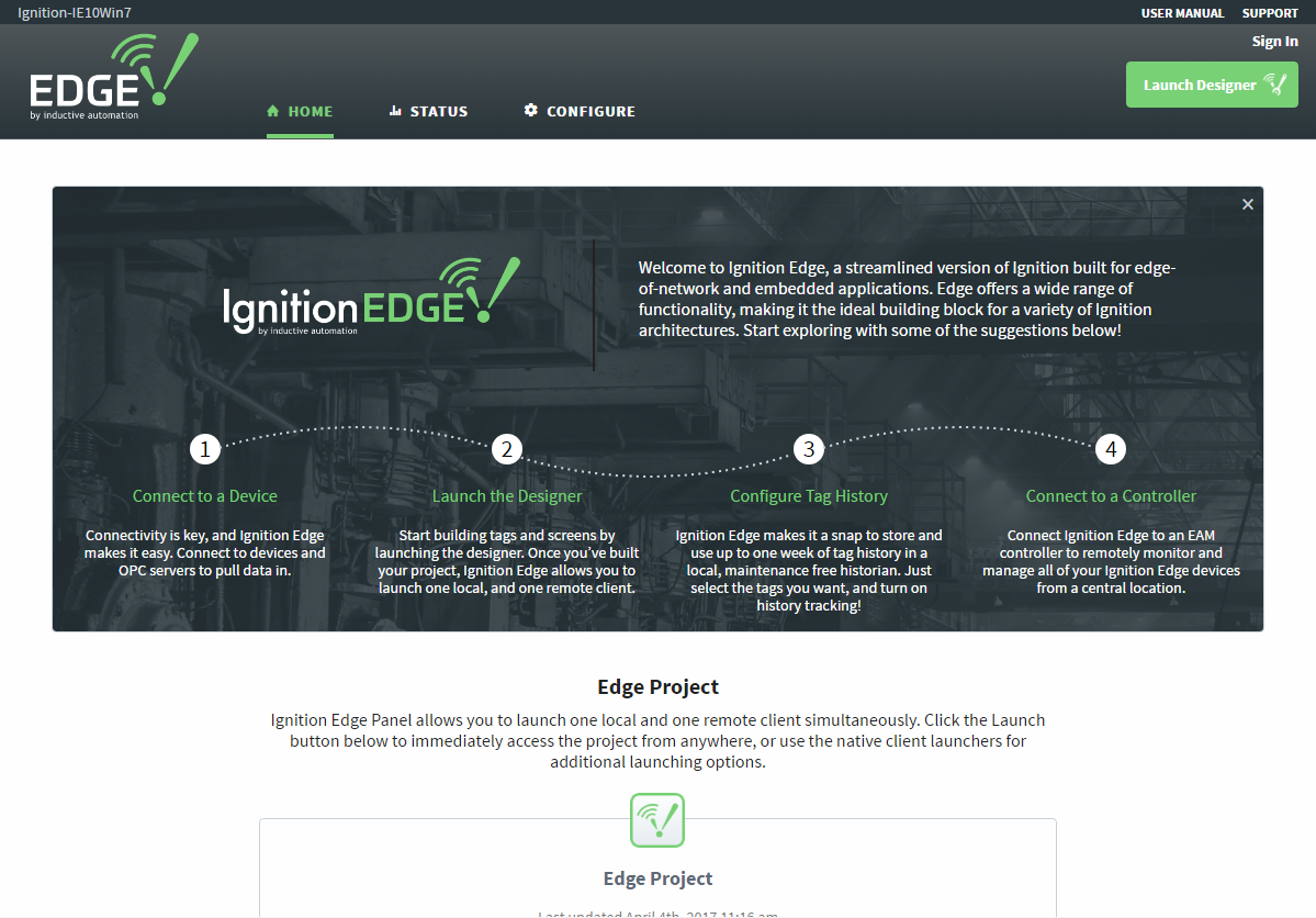

What's Different About an Edge Gateway?​
All Edge installations are a limited version of the Ignition platform for a significantly reduced cost. This helps keep things simple, and these installations can always work with other full versions of Ignition if you need additional functionality. There are a lot of visual changes to the Gateway Webpage, and many pages have been removed to avoid confusion. You can see below that after installing Edge, the traditional orange Ignition logos are replaced with new green Edge logos so a gateway can be easily identified.
Edge Homepage 7.9
