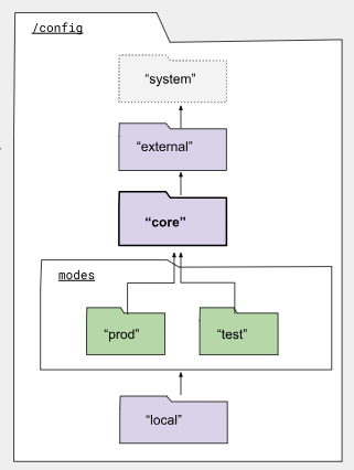

The following diagram illustrates how these collections are structured:
Collections and Deployment Modes Diagram

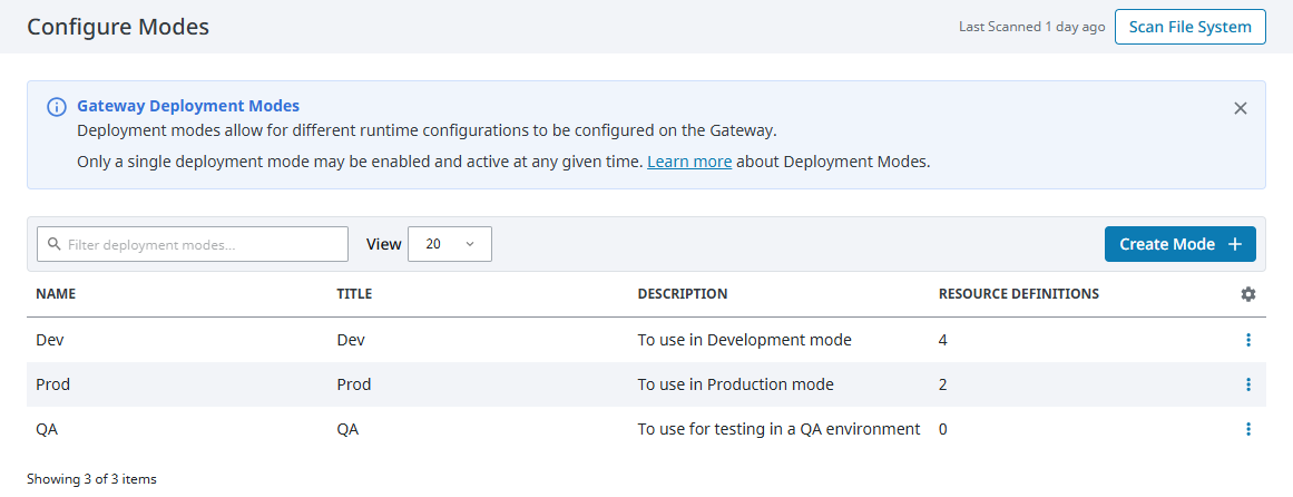

To view your deployment modes on the Gateway Webpage go to Platform > System > Modes. The Modes page will display information about your deployment modes, including the name, title, description, and number of resource definitions.
Gateway Deployment Modes Gateway Page

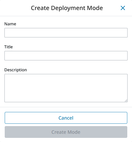

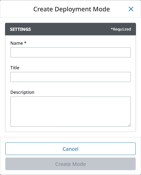

To create a new deployment mode, click on Create Mode on the right side of the page. You will be prompted to provide a name, as well as an optional title and description of the deployment mode. The name and title fields are similar to a project in that it is recommended to change the title of the resource instead of the name, as resource definitions are tied to deployment mode names.
Create Deployment Mode Window

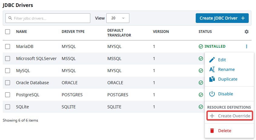

Creating Named and Singleton Resources​
There are three ways to create a Gateway resource, though some of these options will not be available depending on the resource type.
  • Manually create a Gateway resource
  • Overriding Gateway resources
  • Duplicating Gateway resources
New named resources can be created either manually, by overriding, or by duplicating. Overriding and duplicating resources seem similar at first glance, but allow you to customize your deployment modes in different ways. New singleton resources can only be created by overriding.

Overriding Gateway Resources​
Overriding Gateway resources consists of taking existing resources and creating an override that the assigned deployment mode will use. Both named and singleton resources can have overrides.
Overriding Named Resources​

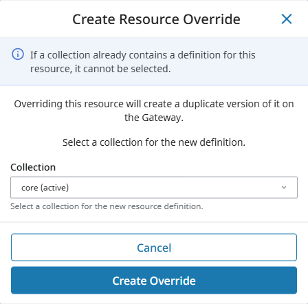

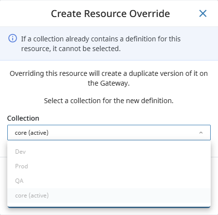

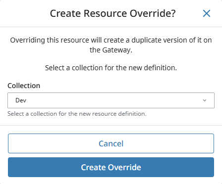

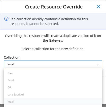

When overriding a named resource, the new resource definition will automatically use the same name as the original resource. You will be able to select a deployment mode to assign the override to using the Create Resource Override popup window.
Create Resource Override Popup

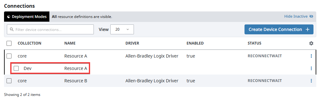

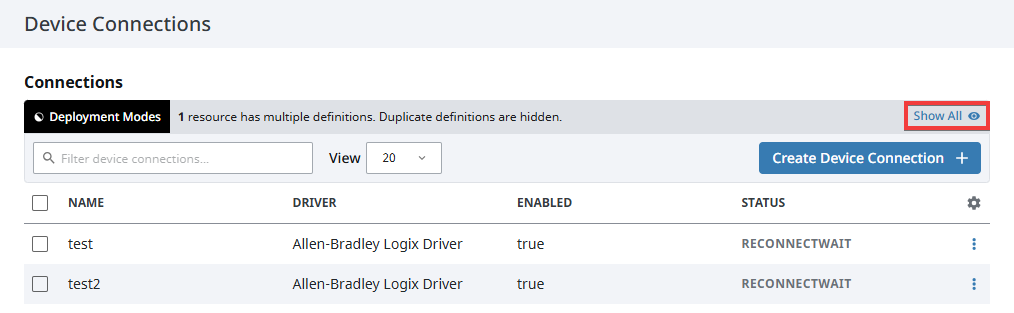

A new banner will also appear at the top of the list. Clicking on Show All will add an additional column to the list that displays which deployment mode the named resource definition is a part of.
Named Resource Definition Show All Button

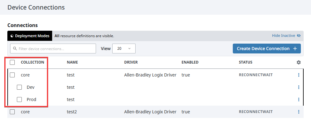

In the image below, there is an Allen-Bradley Logix resource defined on the Dev and Prod deployment modes, in addition to core.
Named Resource Definition Show All Button Origin Column
After clicking Show All, each override will have submenus which you can access by clicking on the three dots menu on the right. Within the submenu, you can edit or duplicate the override, move the overridden resource definition to a different deployment mode, or remove the override completely.

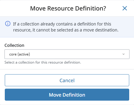

Moving a resource definition allows you to take an existing resource override and place it in a different deployment mode than the currently assigned one.
Move Resource Definition Override

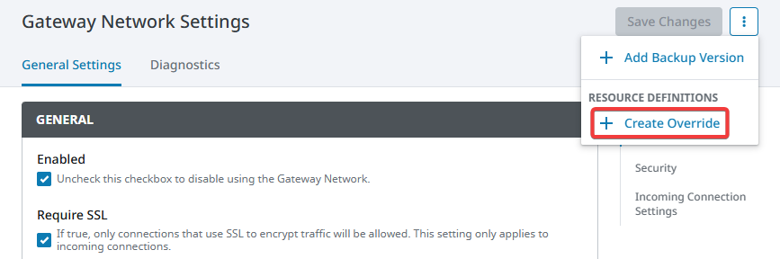

To override a singleton resource, first make sure you have a separate deployment mode available, then navigate to the singleton resource you want to override. Using the Gateway Network Settings page as an example, clicking on the three dots menu on the top right of the page will provide an option to create an override.
Singleton Resource Definition Create Override
When creating a new override, you will be prompted to choose a deployment mode to assign the override to.

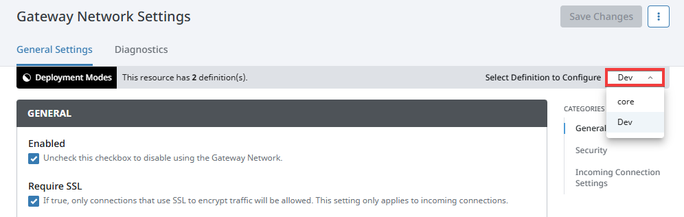

After creating a resource override, a new banner will appear at the top of the form. From this banner, you will be able to select which deployment mode to configure resources for using the dropdown menu on the top right. Toggling between each deployment mode will allow you to configure different settings for separate deployment modes.
Select Deployment Mode Dropdown Singleton

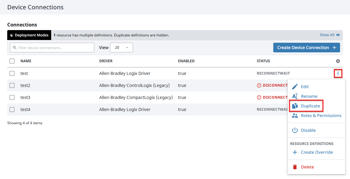

To duplicate a named resource, click on the three dots menu of the named resource you want to duplicate, then click Duplicate.
Three Dots Menu Duplicate Option

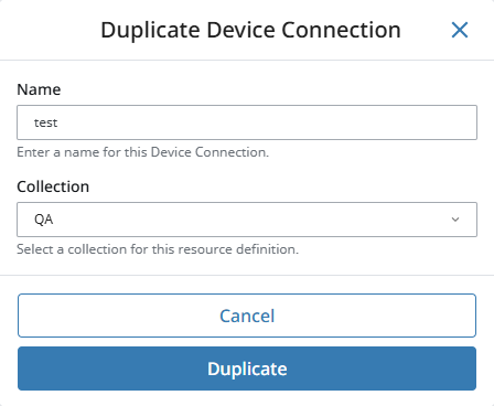

When duplicating resources, you can both change the name of the new resource and assign it to a deployment mode. This creates three duplication possibilities:
  1. Provide a new value for the name of the duplicate resource, and assign the resource to a different deployment mode
  2. Provide a new value for the name of the duplicate resource, and assign the resource to the same deployment mode
  3. Keep the same resource name, and assign the resource to a different deployment mode
note
Duplicating resources is not confined to deployment modes only. You can still use the duplicate feature outside of a deployment mode context if you want to create a named resource with a similar configuration.

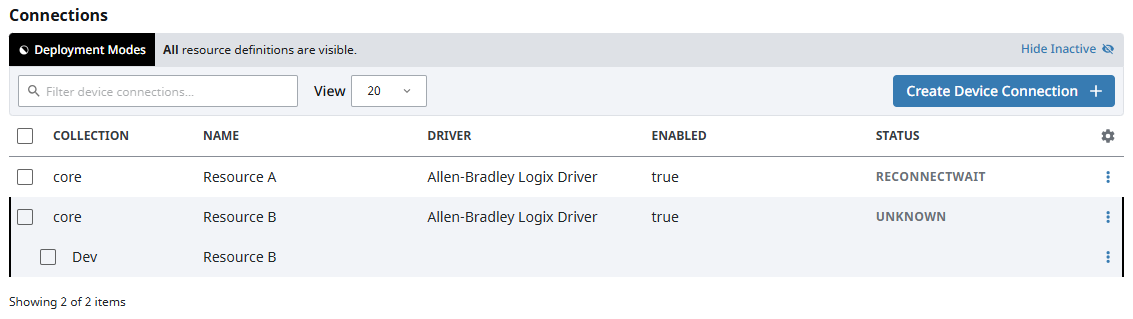

Alternatively, you can create a resource definition with the same name as the duplicated resource within your current deployment mode. The duplicated resource will appear under the new resource definition, similar to creating a named resource override. You will be able to see this duplicated resource by clicking Show All.
Having the same name is the only criteria for a duplicated resource in a different deployment mode to appear. Using device connections as an example, suppose you are currently in the core deployment mode. On this Gateway, you have an Allen-Bradley Logix driver named Resource A within your core deployment mode and an Allen-Bradley Micro800 driver named Resource B within your dev deployment mode. In this instance, since each resource has a different name and are in different deployment modes, only Resource A will appear in your list.

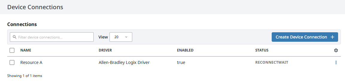

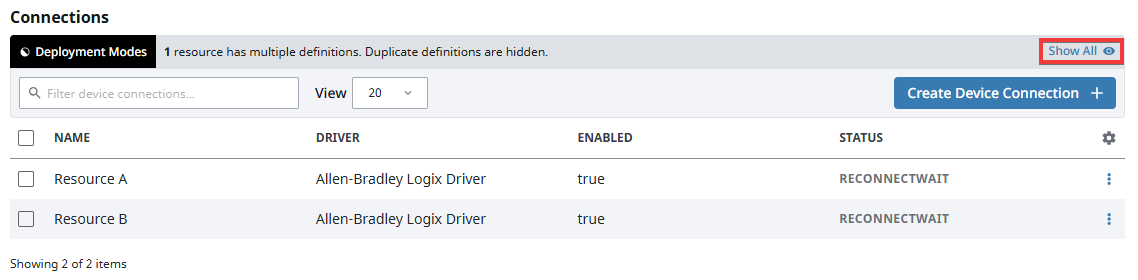

Duplicating Resources Resource A and B Example Figure 1
However, if you duplicate Resource A by naming the new resource Resource B and assigning it to your core deployment mode, both Resource A and Resource B will be visible in your list, even though the driver types are different.
Duplicating Resources Resource A and B Example Figure 2

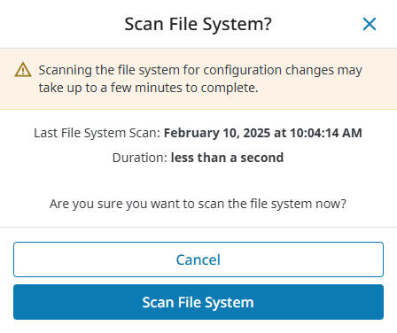

Your Gateway will automatically recognize any resource overrides you create within the Gateway Webpage. However, any changes to your Gateway deployment modes through the Ignition file structure outside of the Gateway Webpage, such as through file manipulation or VCS, will not be automatically recognized. To bring in these changes, you can click on Scan File System on the top right of the Modes page to force your Gateway to check for any file changes. This will open a prompt allowing the Gateway to perform a scan of its file structure to apply any missing changes.
Scan File System Prompt
note
The Scan File System button for Gateway deployment mode differs slightly compared to other buttons of the same name, such as for projects on the Gateway's Projects page. While the Project's Scan File System button only scans the projects section of the file system, the Scan File System button for deployment modes will scan the entire Ignition file system.
