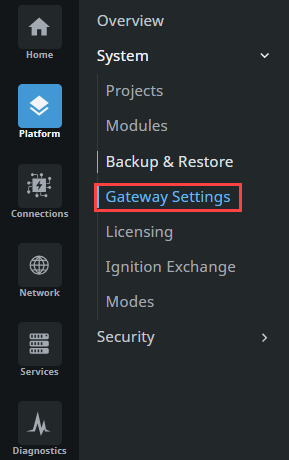

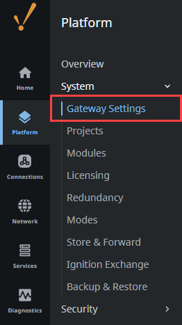

After you launch the Gateway, you can define the high-level settings that apply to the entire Gateway by going to Platform > System > Gateway Settings on the Gateway Webpage. From this page, you can use the default values or define a new setting. The Gateway is at the heart of the Ignition software. It runs as a web server and you can access it through a web browser. Once running, you can get various status information about the Gateway and access important functions.

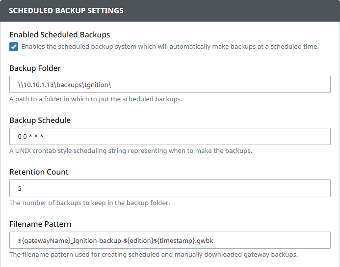

Scheduling Automatic Backups Example​
This example uses an Ignition installation in a Windows environment.
  1. Navigate to Platform > System > Gateway Settings and scroll to Scheduled Backup Settings.
  2. Check the Enable Scheduled Backups box.
  3. Enter your backup folder path into the Backup Folder field. If you are using a network location, ensure the path is specified as a full UNC path and that the Ignition Gateway service has permission to write to the destination.
  4. Configure the Backup Schedule, Retention Count, and Filename Pattern fields as desired.
    tip
    While testing your configuration, you can temporarily set the Backup Schedule to */5 * * * *. This schedules a backup every five minutes and makes it easy to confirm that backups are being created successfully. Once verified, update the schedule to the desired frequency.
  5. Click Save Changes.
After saving, Ignition tests for the presence of the backup location. If the location does not exist, the Gateway attempts to create one. For example, if the file location \\fileserver\ exists, but does not contain a folder named backups, a folder of the same name will be created at that location. If the Gateway cannot create or write to the location, an error appears in the Gateway console, which typically indicates a permissions or access issue with the destination.
As an additional verification step, restarting the Gateway and confirming that new backup files continue to appear in the backup folder can help ensure that scheduled backups persist after restarting the Gateway.
The image below displays an Ignition Gateway configured to save to a network location every evening at midnight.
