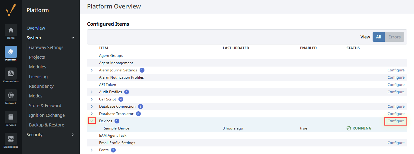

When the Platform tab is first selected, the Overview page is displayed. This page lists all of the configured items within the Gateway. Each item is displayed by their category, number of configured items in that category, and any errors. Use the Configure link to navigate to the respective Gateway page for further configurations, or expand the item using the dropdown icon to see the item names, latest update time, and status.
