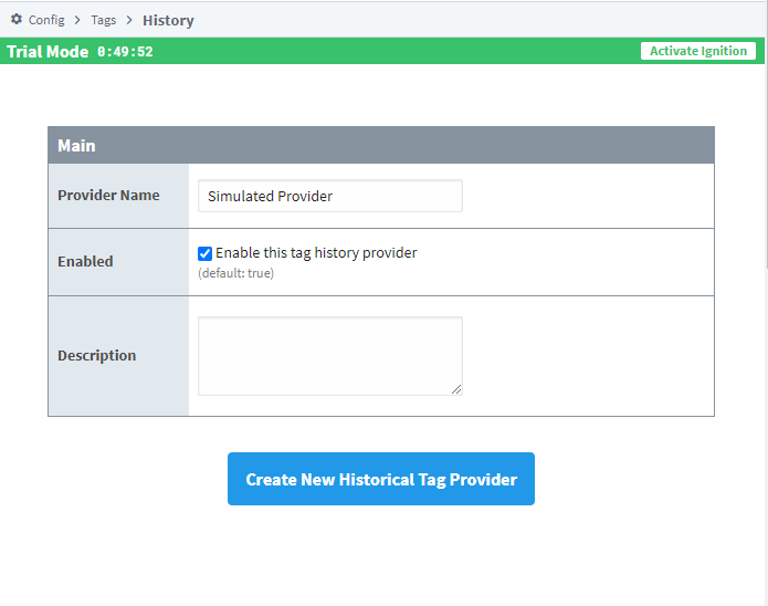

Configuring a Historian Simulator Provider​
  1. On the Gateway Webpage, navigate to the Config section.
  2. Under the TAGS heading in the sidebar, click on History.
  3. On the History Provider listing, click Create new Historical Tag Provider.
  4. From the listing of available types, select Simulator, and click Next.
    Configuring a Historian Simulator Provider Step 4
  5. The simulator requires a unique name from other historical providers on the same Gateway, but otherwise does not require any other configuration settings. The bulk of configuration occurs when attempting to request records from the simulator. For now just provide a name, and click the Create New Historical Tag Provider button to finish configuring the provider.
    Configuring a Historian Simulator Provider Step 5
  6. You'll be redirected back to the History Provider listing. You're now ready to use the simulator.

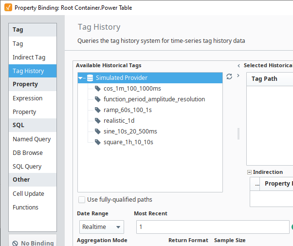

Once a Simulator Provider has been configured, you need a Tag Historian Query to start retrieving records from it. Lots of different interfaces can request Tag Historian Queries, but for the sake of simplicity we'll only focus on Tag history bindings in Vision. Browsing for available historical tags using a Vision Tag History binding reveals the following tags:
Simulated Provider
  • cos_1m_100_1000ms
  • function_period_amplitude_resolution
  • ramp_60s_100_1s
  • realistic_1d
  • sine_10s_20_500ms
  • square_1h_10_10s
Simulated Provider Power Table
To get started quickly, you can use the default tags in the list above. The one exception would be the function_period_amplitude_resolution tag, as that's simply there for syntax reference. The rest of the tags utilizes the simulator's pathing syntax.

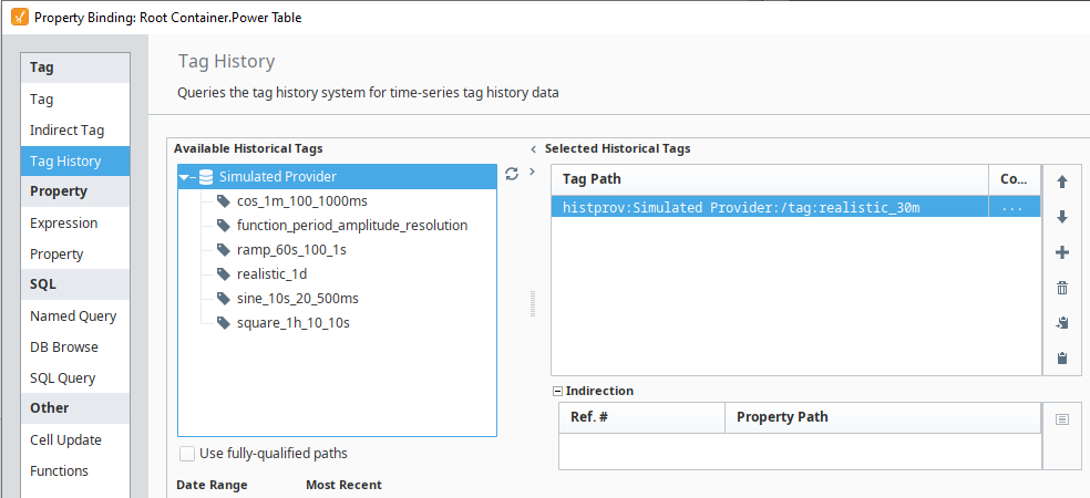

Editing the Paths​
With the knowledge of how the paths work, you can easily use the existing tag history interfaces to request datasets with custom paths, usually by simply typing in the desired parameters.
For example, the image below shows Vision's Tag History Binding interface, but we modified the Selected Historical Tag path to use the realistic function over a period of 30 minutes, instead of the default one day.
Editing the Paths
