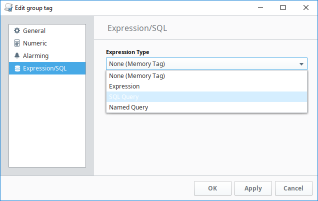

Expression Type​
How an Expression Item determines its value depends heavily on its type.
Expression Type
Expression TypeDefinition
NoneBehaves similar to a Memory Tag in that the value does not automatically change.
ExpressionUses Ignition's Expression Language to determine the value on the Item. The expression can reference other items in the group, as well as Tags.
SQL QueryUtilizes a SQL query to determine the item's value. Thus, a query can execute on the item and the results can be referenced by other items in the same group.
Named QuerySelecting this option will cause the value on the item to be determined by a Named Query in the same project as the Transaction Group.
Refer to the Property Table at the bottom of this page to see the Expression Item Options.

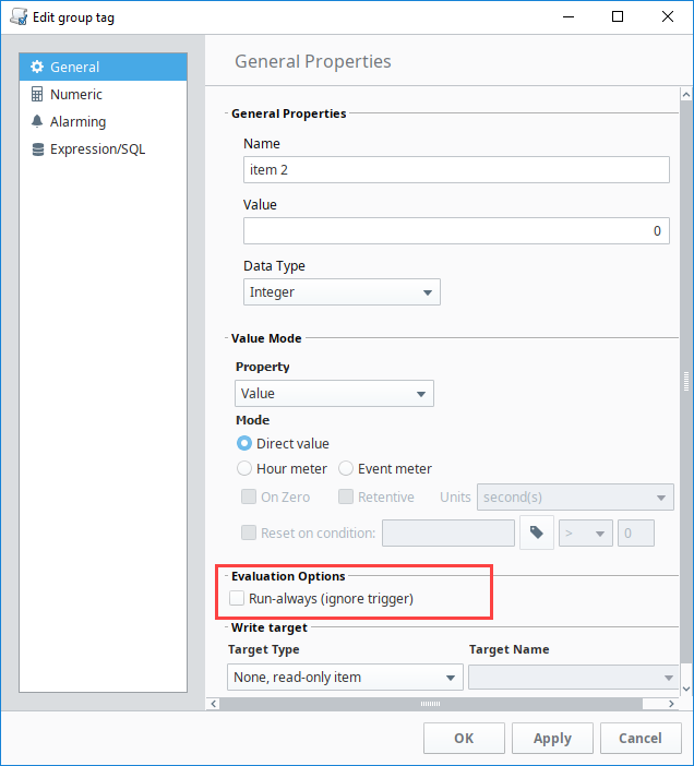

Run Always vs. Triggered Items​
Inductive University
Watch the video

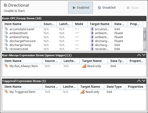

Expression Item can be configured in two different evaluation states:
  • Triggered: The Expression Item executes only when the Transaction Group is triggered. However if the group is not configured to execute on a trigger, then the item will evaluate every time the group executes (similar to how the Run-Always state works). This is the default evaluation state new Expression Items use.
  • Run-Always: The Expression Items will run before the group trigger is checked, so it always executes at the group's rate. This allows your expression to always evaluate regardless of the trigger in the group. Additionally, this state allows you to use the Expression Item as the trigger for the group. We advise that you never have a Target for a Run-Always Expression item because it always runs.
Run Always vs Triggered Items
Hour and Event Meter
Be aware that a Gateway or Transaction Group restart will reset the Source and Latched values of an Expression Item that uses Hour or Event meter modes. Any edits to the Expression Item, such as adjusting the execution schedule, will also reset these values.
Changing the Evaluation State​
Toggling between the two modes can be accomplished by dragging and dropping the Expression Item to either the Run-Always Expression Items table or the Triggered Expression Items table. Alternatively, the evaluation state can be changed by editing the Expression Item and toggling the Run-always (ignore trigger) checkbox.

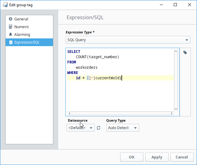

SQL Queries and Expressions​
SQL Query Expression Items
Watch the video
Expression items can use SQL statements and Ignition's Expression language to automatically determine the value of an Expression Item. This is useful in scenarios where you want to use a value from the database as the trigger for the Transaction Group, or aggregate several other items in the group into a single value.
Expressions and queries on an Expression Item can reference the value of other items in the group or Tags in the system by clicking on the Tag (Tag Icon) icon.
There are several Expression functions available that exist only for Transaction Groups. You can find them in the Store and Forward and Variables sections of the f(x) function list.

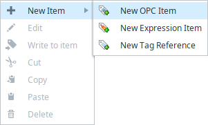

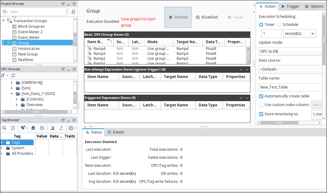

Creating a New Item​
Below is an example of creating a new item. The steps can be applied to any item type.
  1. In the Designer, go to Project Browser, and click on Transaction Groups. The workspace now changes to the Transaction Group workspace.
  2. Right-click on Transaction Group to create a New Transaction Group, or click on a group you have previously created. You will now see the workspace changes to look like:
    Creating a New Item Step 2
  3. Right-click in the white area, and choose New Item > New OPC Item. The options in the popups represent the different item types. Refer to the Item Type Property Table on this page for more information on the various item types and their properties.
    Creating a New Item Step 3
  4. Once you configured the item, click OK.
