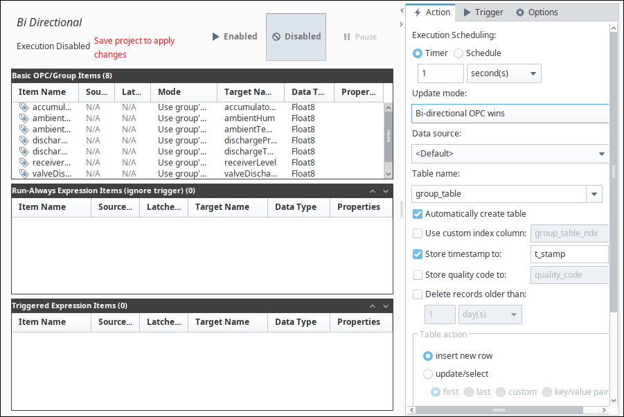

Configuring Transaction Group for OPC to OPC Interaction​
Transaction Groups are generally used to channel OPC data to a database or vice-versa. It is also possible to configure your Standard Transaction Group to be able to get information from one OPC data point to another. This is useful in the event that you have tags coming from one PLC and you need the tag information to be sent to another PLC on your plant floor.
  1. Create a Standard Transaction Group and from your Tag browser.
  2. Drag two Tags into your Transaction Group's Basic OPC/Group Items section. For this example, the Tags will be called tag1 and tag2 and they will be coming from two different PLCs.
  3. Set the mode on tag1 to Bi-directional OPC Wins and set its Target Name to be tag2.
  4. Set the mode on tag2 to be Bi-directional OPC Wins and set its Target Name to Read-only. The mode on tag2 is not as important here as it is a read-only item, but we set it to Bi-directional OPC Wins anyway.
    Configuring Transaction Group for OPC to OPC Interaction Step 4
    This will make sure that every 1 second, the value from tag1 will be written to tag2.
