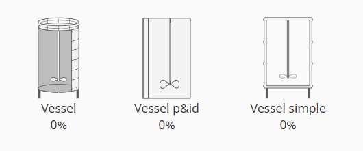

An animated component that looks like a tank or vessel. Options include displaying fill level, the stand, and the agitator. Full menu of style options is available for text, background, margin and padding, border, shape and miscellaneous. You can also specify a style class.

appearanceOptions for the appearance of the component. Options are auto, p&id, mimic, and simple. If set to auto, the value is taken from the Perspective Session Property symbols.autoAppearance.

orientationOrientation of the vessel. Options are horizontal or vertical. Default is vertical.value: string
displayStandWhether or not to display the stand for the vessel. Default is true.value: boolean
displayAgitatorWhether or not to display the agitator in the vessel. Default is true.value: boolean
displayFillLevelWhether or not to display the fill level of liquid in the vessel. Default is true.value: boolean
