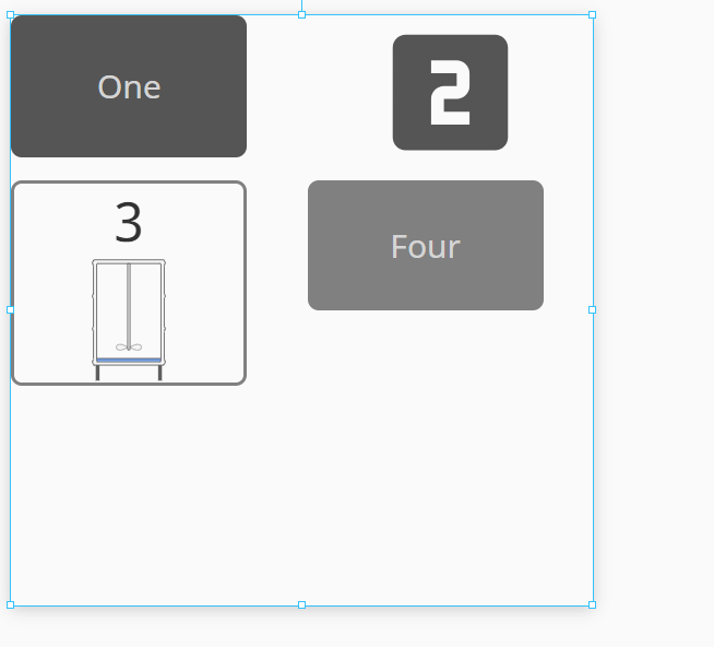

A column container provides a way to create a single set of components that can be arranged up to three ways depending on the width of the container. Components are able change how many columns they span when switching between breakpoints, as well as change row and column index altogether. In the GIF below, the components are resizing and repositioning as the viewport on the container changes.

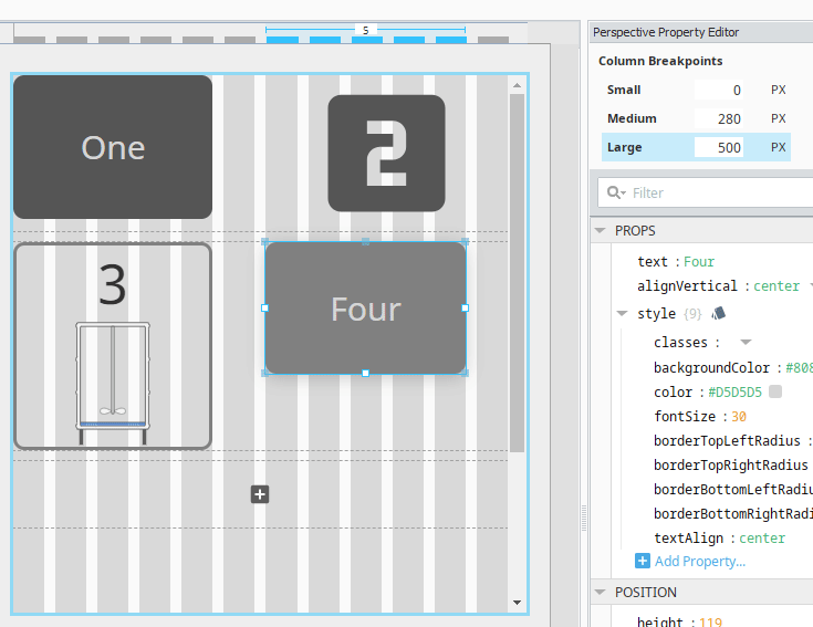

While deep selected, the Perspective Property Editor will show a Column Breakpoints interface. Clicking on Small, Medium, or Large will change the container workspace, showing you the current configurations for all child components in the container. When a container workspace is selected, you can freely move and resize components for the selected breakpoint, allowing you to determine their placement when the selected breakpoint is active in a session.
Note that switching between breakpoints in the designer does not resize the container. The pixel dimensions represent a minimum width for the viewport, meaning that the container will switch to the breakpoint when the minimum width is satisfied during runtime. For example, if Medium is set to 280px and Large is 500px, then the container will show the medium breakpoint when the viewport is between 280 and 499 pixels in width.

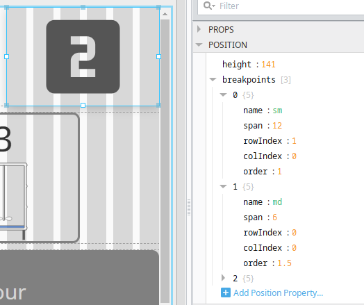

breakpoints | An array of objects, where each object represents a different breakpoint. In the image below, a component in a column container is selected. Each element under breakpoints contains positioning information that will be used when the container switches to the named breakpoint. ![]() | array |
Breakpoints Child Properties
Property | Description | Property Type |
name | Name of a breakpoint defined in container. If this matches the currently applied breakpoint, these rules determine child layout. Options are sm (small), md (medium), or lg (large). | value: string |
span | Number of columns the child's width will span. | value: numeric |
rowIndex | Row index (starting from 0) in which to place child. Children may wrap lines within a row. Children in separate rows don't affect each other's layout. | value: numeric |
colIndex | Column number upon which the child's span should begin unless forced to wrap. | value: numeric |
order | Where component is places among its siblings within its row. Ordering is independent per row. | value: numeric |
