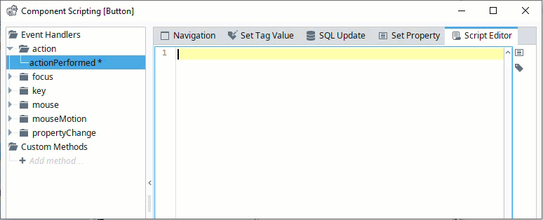

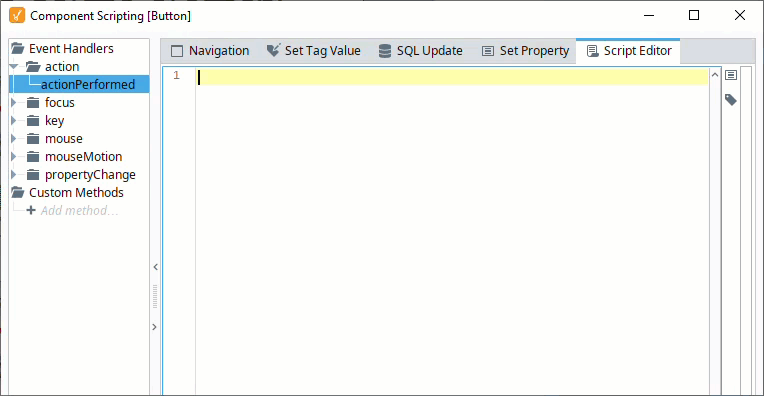

  3. Let's add a script that triggers when the Button is pressed. With the Button component selected, right click on Scripting to open the Component Scripting window.
  4. Under Event Handlers, select the action > actionPerformed option, and click the Script Editor tab. Make sure the actionPerformed event is highlighted. If an event is not selected, all of the remaining features in this window will be disabled, so we will not be able to write a script. Additionally, if the wrong event is selected, then our script will not trigger when we expect it to.
  5. In the Script Editor, you will see a large editable Text Area. This is where we will type our script.
  6. Let's generate a message that shows "Hello World!" Use the following code to get started. Make sure the word "print" lines up exactly to the left edge. Indention in Python means something, so we need to avoid starting our lines with a space or tab unless we're denoting a block of code under something like an if-statement or function definition. Click OK to close the Component Scripting window.
    Python - Simple Print
    print "Hello World!"
    Notice the actionPerformed event is blue and bold. This means there is a script on this event. This is useful to know in situations where a component has scripts on multiple events.
    Additionally, an asterisk character ( * ) is next to the event. This means you have not applied/saved the changes to the script. The asterisk will disappear when you press either OK or Apply, and reappear whenever you make a change to the script. If you see this, then it means you may want to save any changes you made.
    The Script Editor tab also has a blue color, denoting where the script is. An event will only ever have a script located on a single tab at any time. If a new tab is selected and configured, it will wipe out the work on the prior tab, for example, writing a script on Script Editor and then configuring the Navigation tab will erase the script on the Script Editor tab.

  1. Open the Component Scripting window again, and find the script on the Button.
  2. We will use one of Ignition's built-in functions, called system.gui.messageBox, to display the message. This will make a message box appear, which is a modal window that we can pass a string to. Remove your old code on the Button, as we will be replacing it. Start by typing the following:
