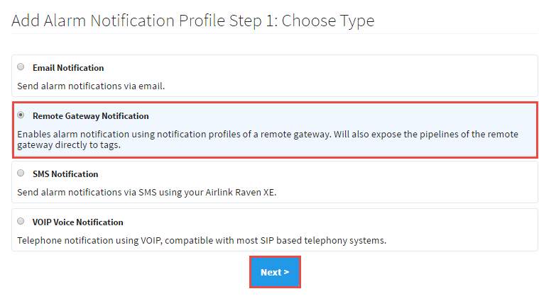

  2. The Add Alarm Notification Profile Step 1 window will appear. Select Remote Gateway Notification, and click Next.
    Alarm Notification Add Remote Gateway Notification Profile Step 1

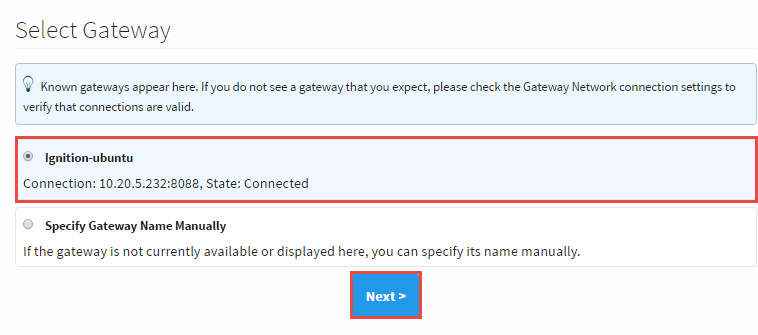

  3. All the known Gateways will be displayed. Choose from the list of available Gateways or you can setup a Gateway manually, then click Next.
    Alarm Notification Remote Notification Select Gateway

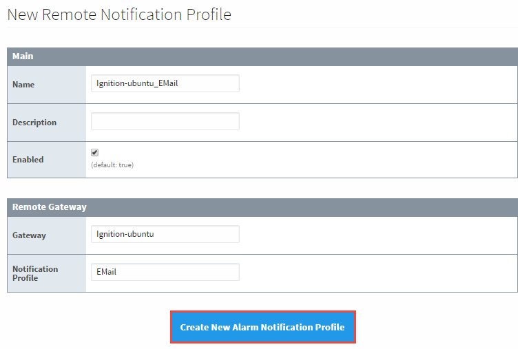

  5. The new Remote Notification Profile window will appear. It will automatically show the name of your Gateway followed by the name of the remote Profile unless you are manually specifying a remote profile. There is a naming convention that is used when identifying the 'Name' of the New Remote Notification Profile. It is the Gateway Name followed by an underscore and the name of the Profile (i.e., Ignition-ubuntu_Email). Click Create New Alarm Notification Profile.
    Alarm Notification Remote Gateway Create New Profile

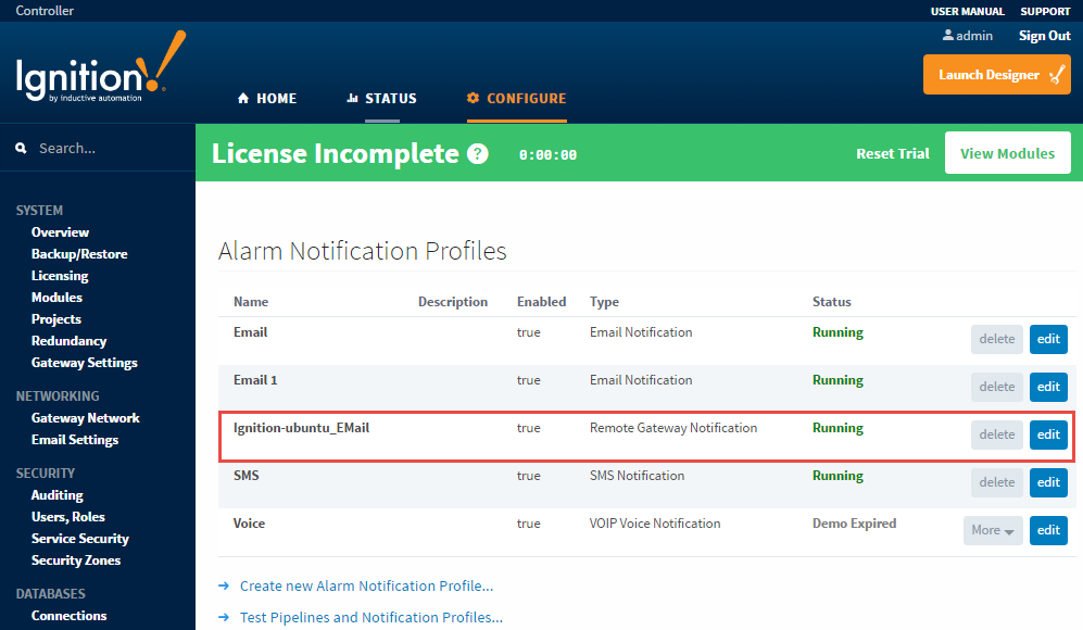

  6. The Alarm Notification Profiles window will open showing all your alarm profiles, including the one you just created.
    Alarm Notification Profiles Remote Gateway

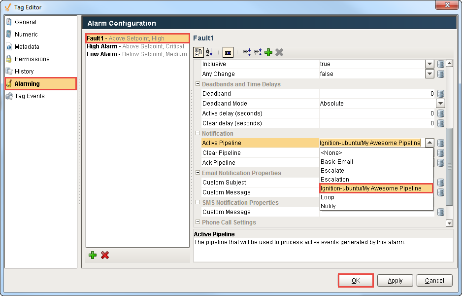

  1. In the Designer, under the Tag Browser, double click on your Tag (i.e., WriteableFloat1) to open the Tag Editor.
    Tag Browser WritableFloat1 Tag
  2. In the Tag Editor, click Alarming, and select your alarm (i.e., Fault1). (If you don't have an alarm, then you'll need to add an alarm. Refer to the section on Configuring Alarms). Scroll down to the Notification area and under Active Pipeline, select the remote pipeline (i.e., Ignition-ubuntu/MyAwesome Pipeline) that you want to use from the dropdown list. Click OK.
    Alarm Notification Tag Editor Alarm Configuration
