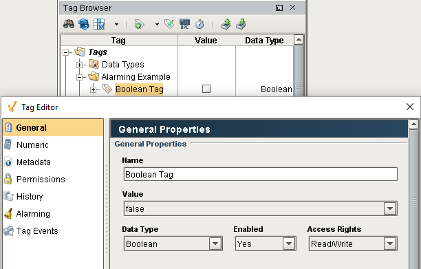

  1. Double-click on the Tag to edit it. The Tag Editor window will appear. For this example, a Memory Tag with a Data Type of Boolean will be used
    Configuring an Alarm on a Tag Step 1

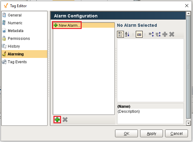

  2. On the left side of te window, click on Alarming.
  3. Either click on the green plus sign towards the top of the window, or double click the New Alarm Icon item to add a New Alarm to the Tag.
    Configuring an Alarm on a Tag Step 3

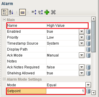

  4. Enter a Name for the Alarm and set any other settings you wish. In the image below the Name was changed to "High Value" and the Setpoint was changed to 1. This means that when the value on the Tag is equal to 1 (or True in the case of a boolean) then the alarm will become active.
    Configuring an Alarm on a Tag Step 4

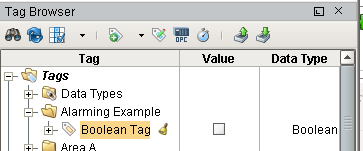

  5. Click OK to commit the new alarm.
  6. Ignition will start monitoring the alarm immediately. Note the alarm icon Alarm Icon next to the Tag. This means that at least one alarm is configured on this Tag.
    Configuring an Alarm on a Tag Step 6

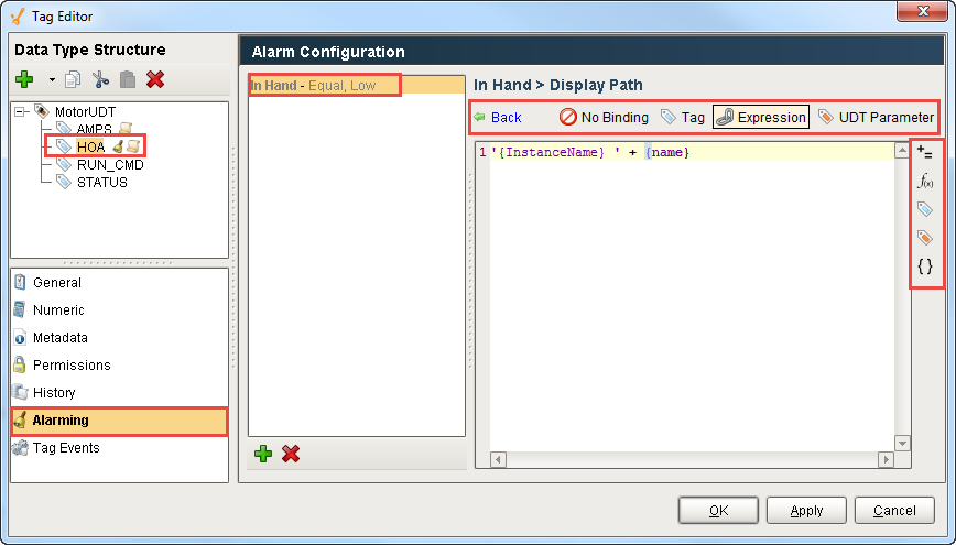

Many alarm properties are bind-able, which means they can be bound to other Tags in the system, or expressions. For example, you might bind the enabled property to another Tag which represents whether or not your process is running, thereby disabling the alarm when production is stopped. Or, you might bind the setpoint of an alarm to a Tag that operators can manipulate, thereby letting the setpoint be changed at runtime.
To bind an alarm property, simply click on the binding icon Binding Icon, and the binding UI will slide in from the right. From here you can select the binding type (No Binding, Tag, Expression, or UDT Parameter, if applicable). Note that the expression can reference many useful values such as the Tag's value and other settings of the alarm. When you've configured the binding to your liking, click on the "Back" link at the top of the screen.

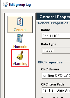

Alarms can also be added to OPC items in Transaction Groups. This means alarms can be used without ever creating a Tag in Ignition. Simply edit an OPC item, and an Alarming section will appear on the side of the Edit Group Tag window. From here, adding an alarm to the item is similar to adding an alarm to an Ignition Tag.
Alarms in Transactions Groups
