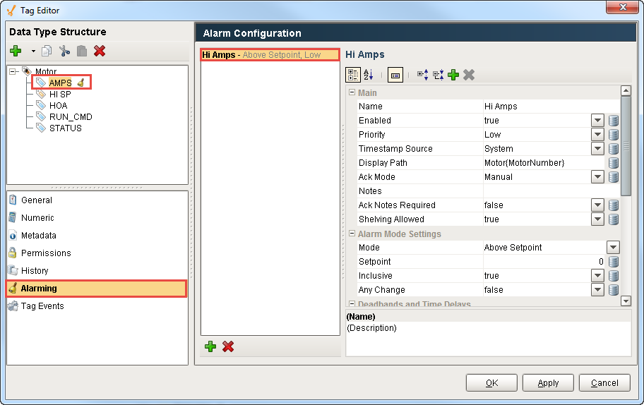

  1. In your Tag Browser, go to the Data Types folder, and double click on a UDT to edit the definition. This example uses a Motor UDT.
    Configure an Alarm on a UDT

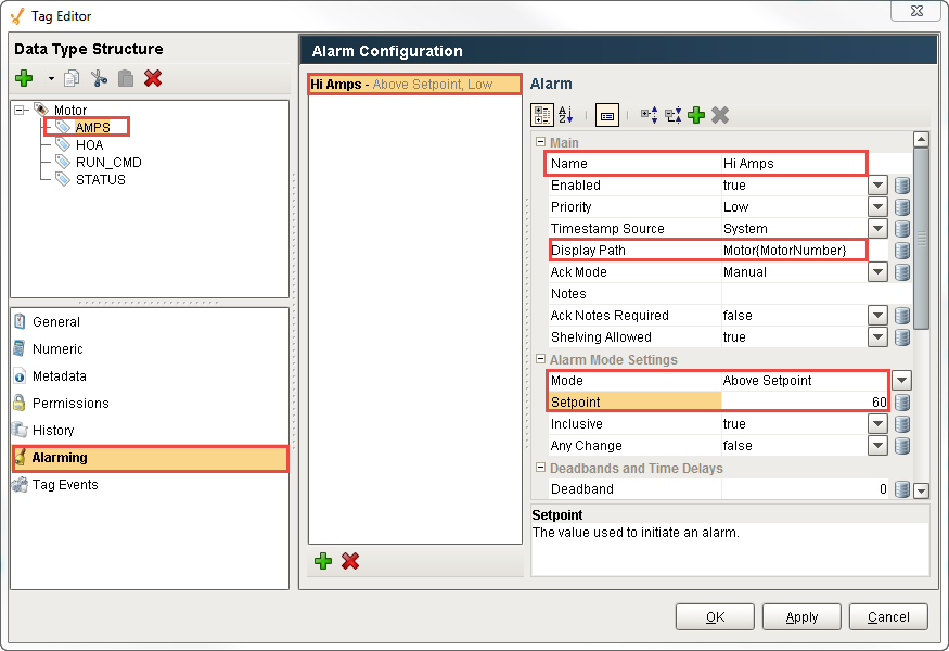

  2. Select a Tag, and click on the Alarming tab to add an alarm inside the UDT definition. Enter an Alarm Name, Display Path, Mode, and Setpoint. UDT configurations are set up the same way as the normal alarm configuration on a tag.
    Display Path
    Since you have multiple instances of a Motor, as in this example, you need to make sure that the Display Path is unique for every instance, otherwise, every instance of the UDT will have the same Display Path name, and the operator won't know which alarm to respond too. There are a couple of ways to address this: you can leave the Display Path blank, in which case, Ignition will use the full Display Path to the instance of that tag, or you can bind a property to an expression involving a UDT parameter (i.e., Motor + {MotorNumber}).
  3. Click OK. Now, all instances of the UDT will have a similar alarm setup, but each alarm will be unique to that UDT instance.

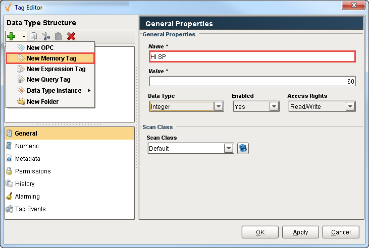

  2. Create a Memory Tag inside the UDT definition to serve as the setpoint, and give it a name (i.e., HI SP).
    Configure Dynamic Setpoints Inside a UDT Step 2

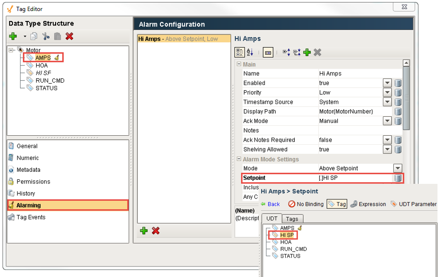

  3. Select the Tag (i.e., AMPS), and the alarm inside the UDT definition (i.e., Hi Amps) that has the alarm that you want to associate with the UDT.
    Configure Dynamic Setpoints Inside a UDT Step 3
  4. Bind the Setpoint property to the new UDT Memory Tags (i.e., HI SP).
    Configure Dynamic Setpoints Inside a UDT Step 4
  5. Click OK. All of the deployed UDTs will now have Memory Tags that serve as the alarm setpoints.
