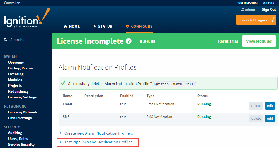

  1. Go to the Gateway webpage and select the Configure section.
  2. From the menu on the left, select Alarming > Notification. The Alarm Notification Profiles page will open.
  3. Simply click the Test Pipelines and Notification Profiles... link.  The link will navigate you to a testing page.

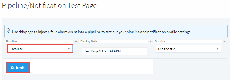

Alarm Notification Pipeline Testing
  1. Select your configured Pipeline, and click the Submit button.
Alarm Notification Testing Pipeline Selection

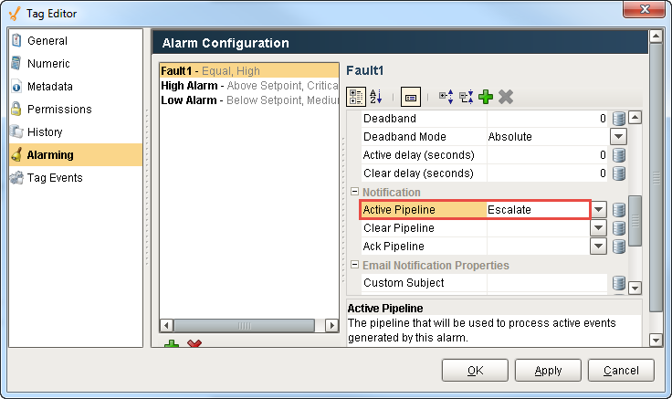

  1. Once the system has been tested successfully, the last step is to assign a pipeline to your alarms. This can be done by editing your Tags in the Designer. Go to your Tag Browser and double click on your tag. The Tag Editor will open, and click on Alarming. Select an alarm and go to the Notification section, and choose a pipeline (i.e., Escalate) to assign to your alarm. Click OK.
Alarm Notification Testing Pipeline Assignment
Now, when an alarm occurs, an alarm notification will be sent to the users in the On-Call Roster whose schedule is active.
