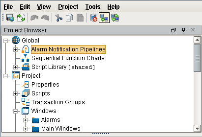

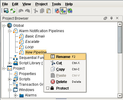

  1. In the Designer, create a new pipeline in the Project Browser by going to the Global area.
    Create Simple Alarm Pipeline Step 1
  2. Select Alarm Notification Pipelines, and right-click to create a New Alarm Notification.

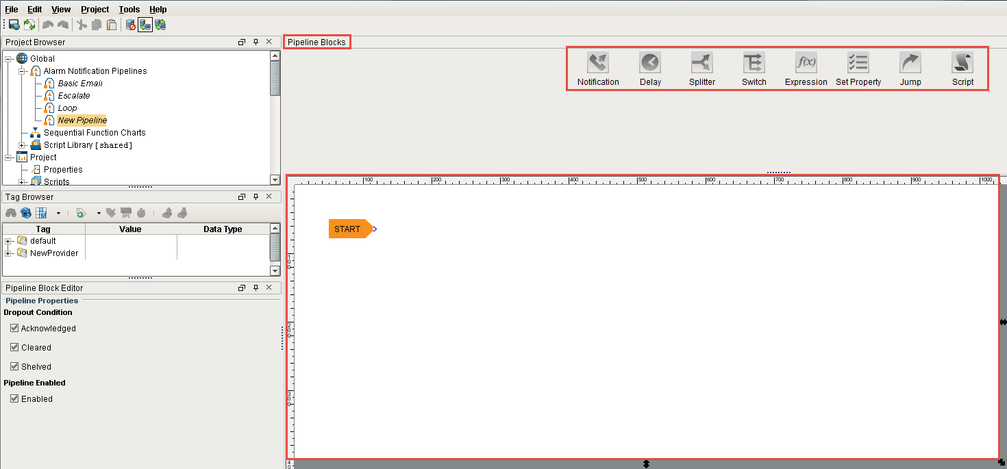

    When you create a new pipeline, the Designer switches to the Pipeline Workspace. The workspace is essentially a blank canvas and can contains various Pipeline Blocks. By default, the name of the new pipeline is called "New Pipeline".
    Create Simple Alarm Pipeline Step 2 with empty Designer space

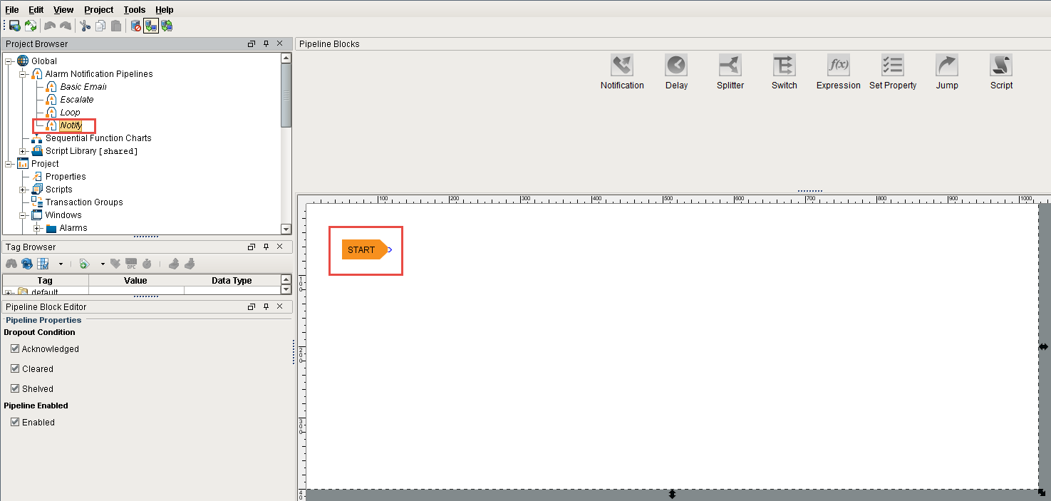

  3. It is a good practice to give a meaningful name to the pipeline. Commonly, the name acts as a way to describe what the pipeline does. Select your ‘New Pipeline’, right click and Rename it to ‘Notify’.
    Create Simple Alarm Pipeline Step 3
    Every pipeline has a Start Block which you will see when you create your pipeline. When an alarm is triggered, it automatically goes to the Start Block, and from there you can use other pipeline blocks to determine what you want to do with that alarm. All the available pipeline blocks are shown at the top of the Pipeline Workspace.
    Create Simple Alarm Pipeline Step 3 with empty Designer space

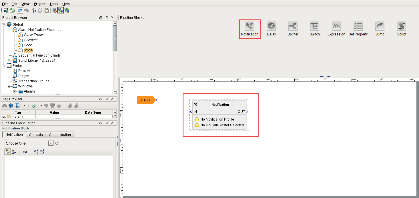

  4. The most basic pipeline you can create is to simply notify someone right away when an alarm occurs. Drag the Notification Block on to your canvas and place it next to the Start Block. Keep in mind that even though the two blocks are on your canvas, they are not yet connected.

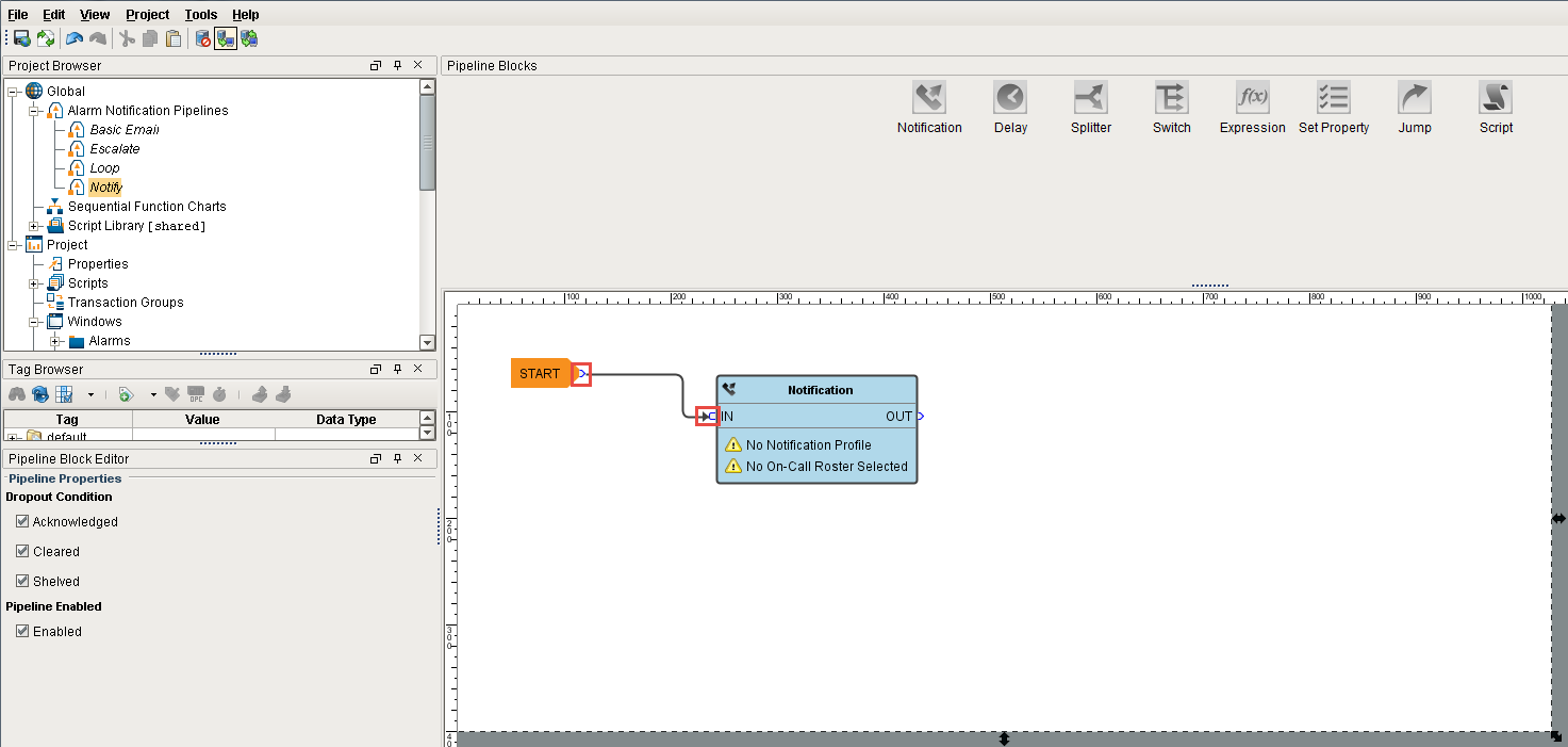

  5. Drag the output pin from the Start Block to the input pin of the Notification Block connecting the two blocks. When an alarm occurs, it's going directly into the Start Block and then into the Notification Block.

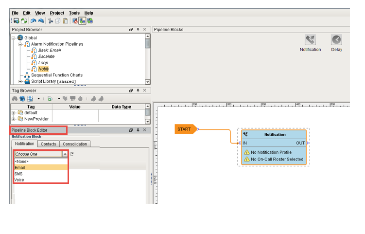

  6. On the Notification Block, you have to configure the Alarm Notification Profile that you are going to use and who you are going to send it to. You should have already configured your Alarm Notification Profile before creating your new pipeline.
    In your pipeline workspace, click on the Notification Block, and the Notification tab will open. Choose which Notification Profile from the dropdown that you want to use: Email, SMS or Voice. You can see that all three profiles are configured, but for this example, choose Email.
    Create Simple Alarm Pipeline Step 6

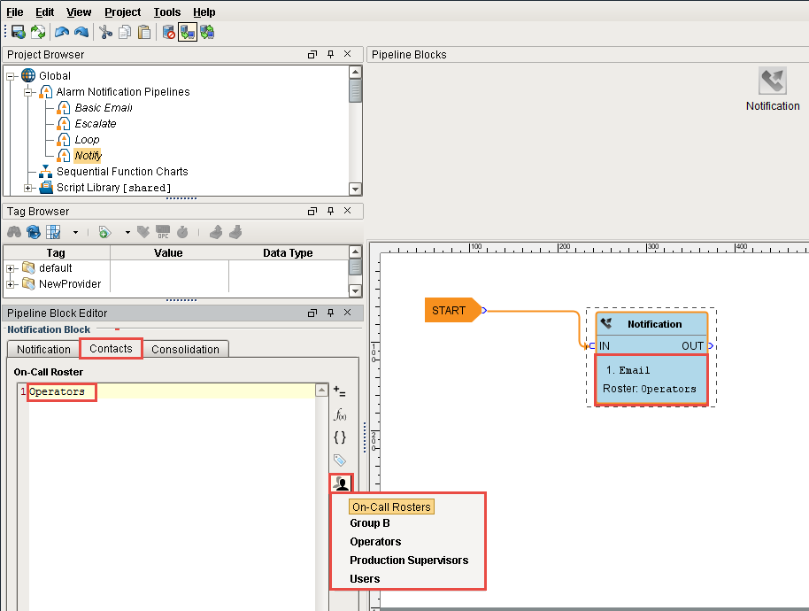

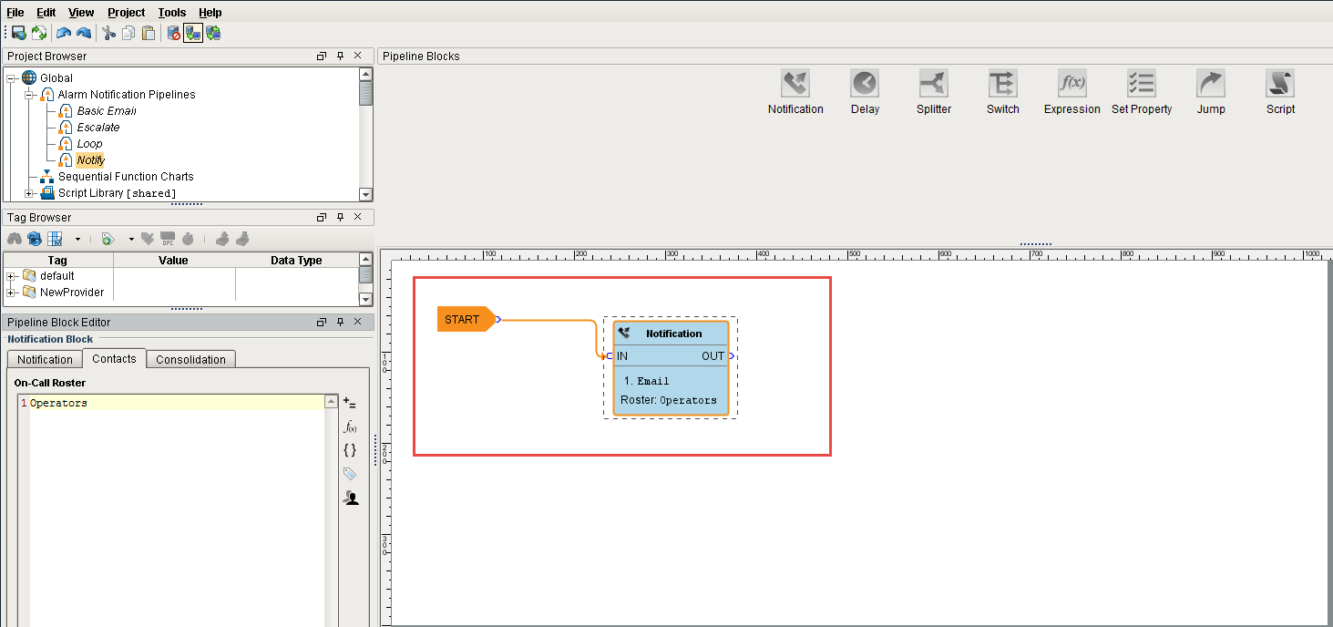

  7. In the Pipeline Block Editor, under Contacts, click the On-Call Roster icon on the right side. Select from users and groups who you want to notify about this alarm. Your On-Call Roster should have already been created before creating your pipeline.
    Create Simple Alarm Pipeline Step 7
You just created a very simple Alarm Pipeline. When this alarm becomes active, it goes directly to the Start Block and notifies all the users in the Operator group via Email one time.
Create Simple Alarm Pipeline Final Pipeline
