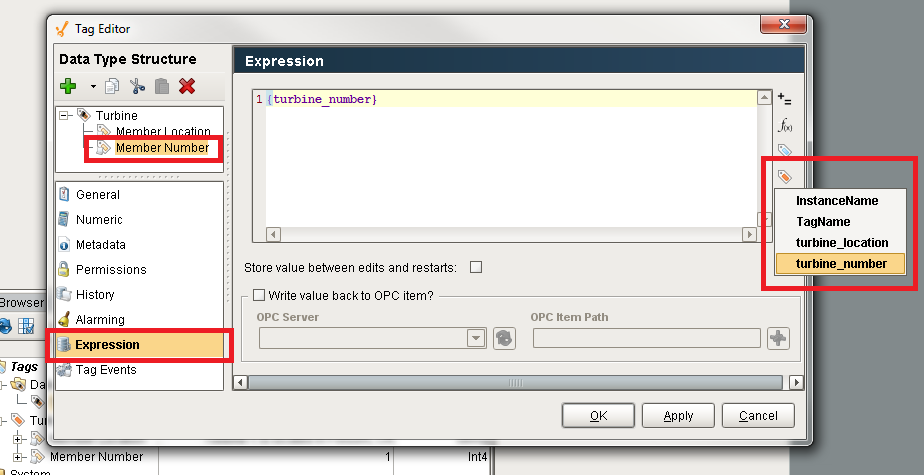

It is possible to use the value of data type parameters directly in expression bindings within a UDT. Parameter references can be quickly inserted into an expression by clicking on the UDT Parameters button on the right of the expression area.

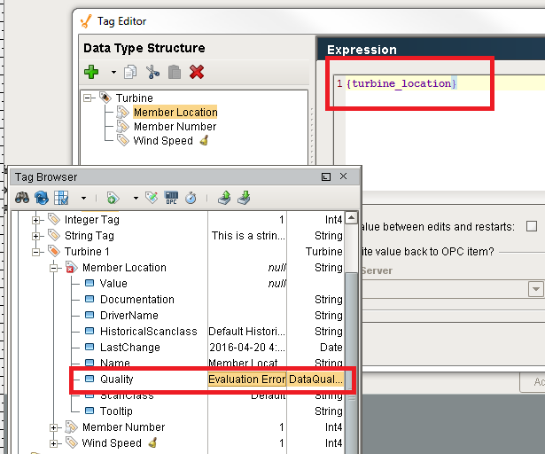

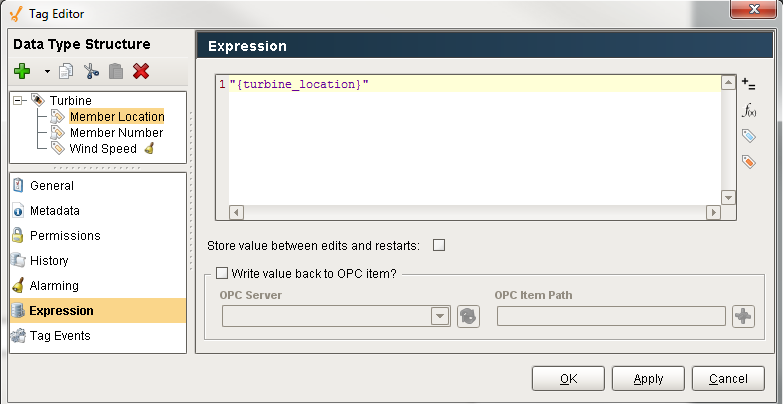

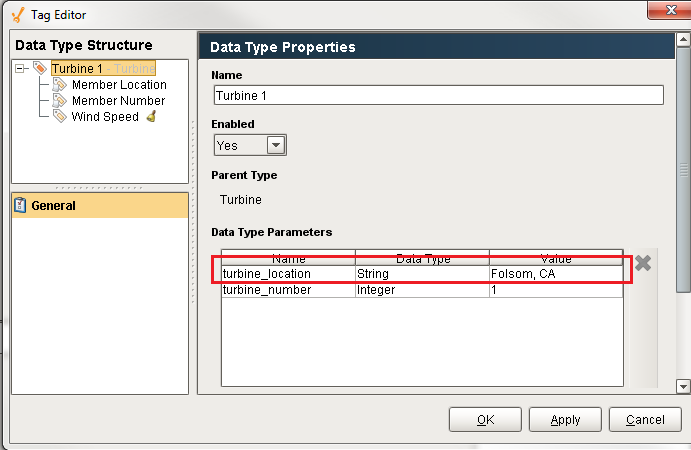

Below is an instance of a Turbine UDT. It contains a string parameter named "turbine_location".
Inside the Turbine UDT is an expression Tag named Member Location. To show the value of the turbine_location parameter on Member Location, the following expression would be used on the UDT definition.
Omitting the quotation marks would result in an evaluation error.

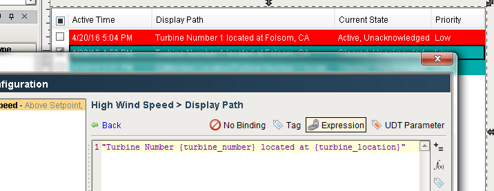

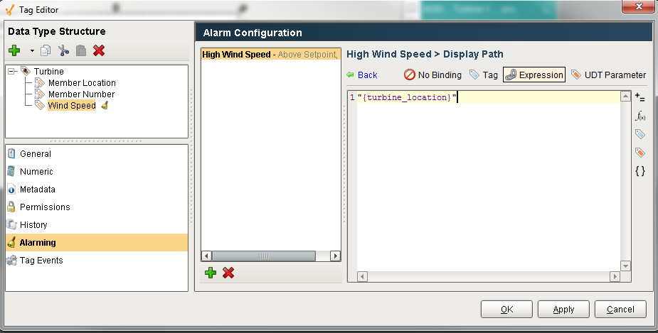

The same syntax should be applied to parameters in bindings on alarm properties. Below is an example using the same UDT, but the expression is instead located on the Display Path property of an alarm.
Additionally, non-string parameters and static values can be included in the same quotation marks.

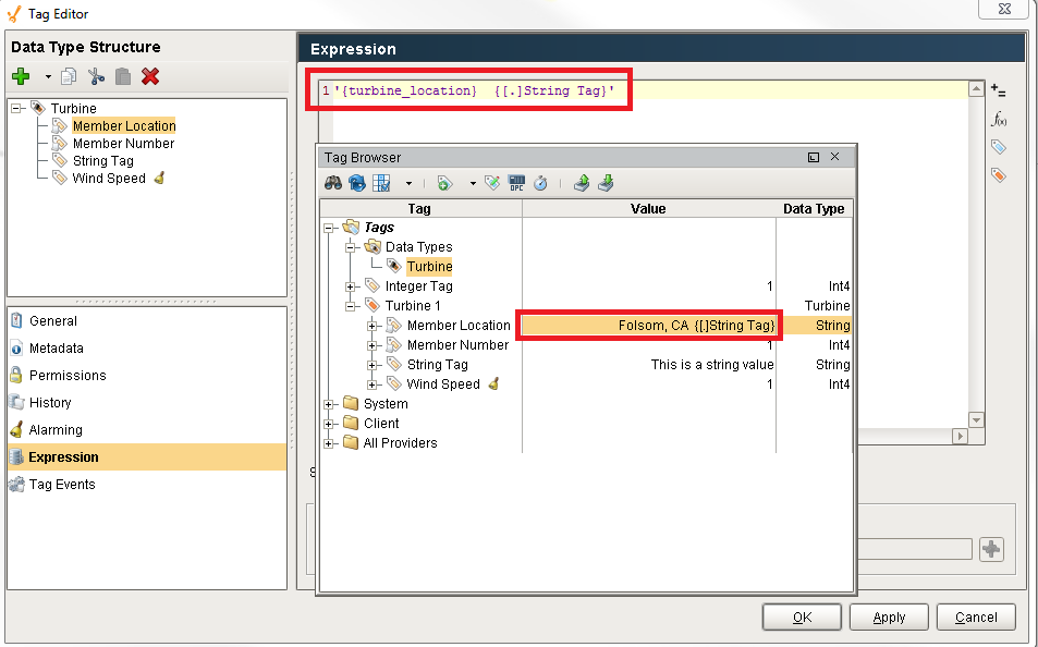

Because parameter and Tag references differ in syntax, some consideration must be made when attempting to use both in the same expression. Tag references must not be placed inside of quotes. After adding a string Tag to the Turbine UDT, a reference to the Tag can be added to Member Location's expression.
Adding quotation marks around the Tag reference would result in the literal value of the reference appearing in the value of the Tag.
