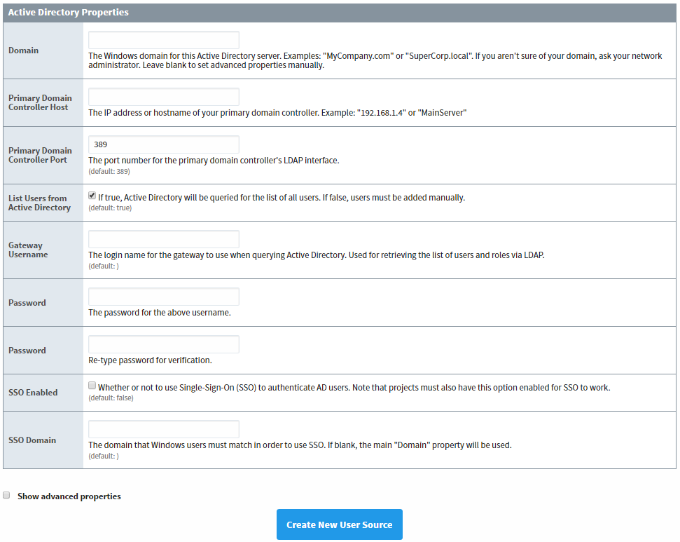

To set up an AD/Internal Hybrid User Source, you must specify the host that is acting as your primary domain controller. You can also use a secondary domain controller in case the primary is unavailable. You'll also need to specify the name of the domain and credentials for the Gateway itself to use for authentication for when it queries the list of roles.
May need to contact your internal IT Department for...
When using AD/Internal Hybrid User Source, you may need to consult with your internal IT Department to get the required information to complete your user source setup.

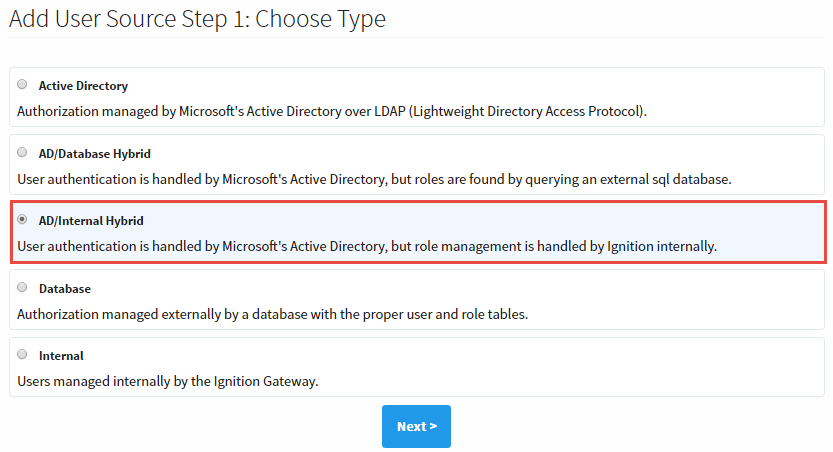

  2. Choose the AD/Internal Hybrid authentication type, and click Next.

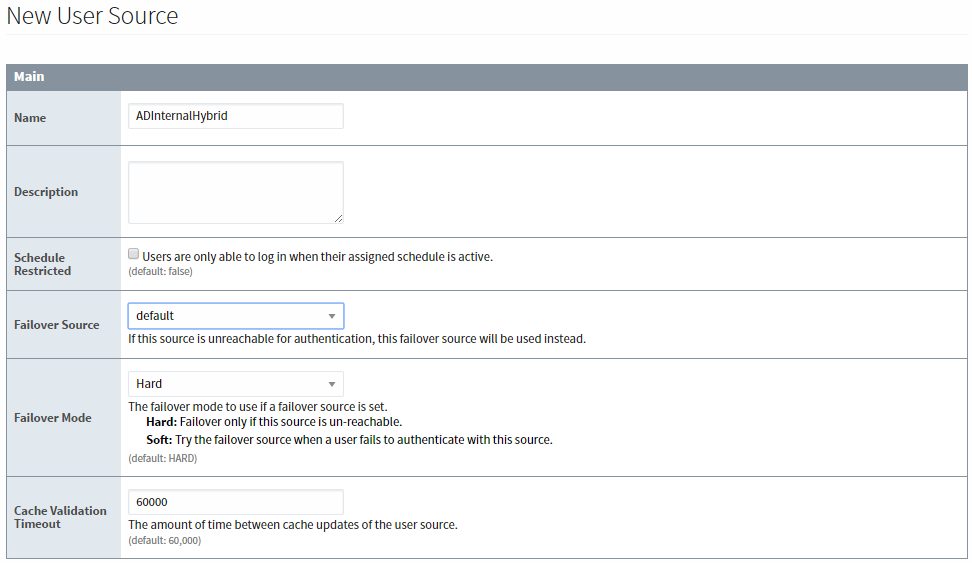

  3. The New User Source window will open. Some properties are optional depending on how you setup your profile.
