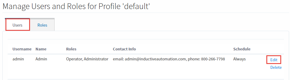

  1. On the Gateway webpage under the Configure section, go to Security > Users, Roles. The default user source contains the 'admin/password' combination to access the Configure section.
  2. Click on manage users and you will see the admin user.

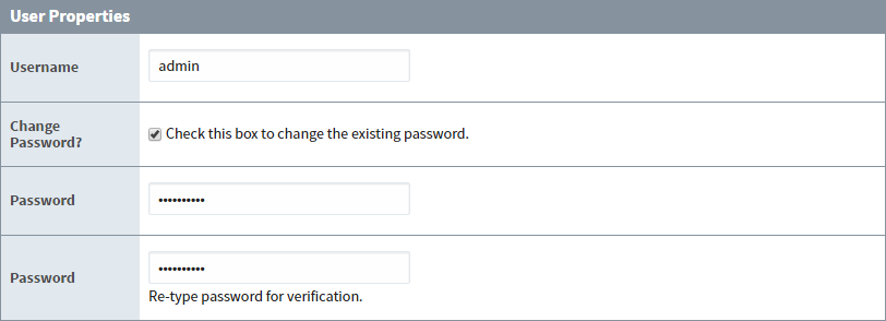

  3. On the right side, click edit to change the password for the admin user.
  1. Click the checkbox to change the existing password.
    Enter the new password, then re-type the new password to confirm it.
  1. When you're finished, click Save Changes.
  2. To test the new password, logout and log back in as the admin with the new password.

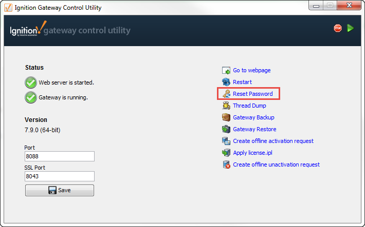

Password Reset​
Ignition provides you with the capability to reset the admin password from the Gateway Control Utility (GCU). The default is user/password combination is 'admin/password,' and will grant access to the Gateway webpage. Normally, this is not considered a security risk because the GCU can only be used from the machine the software is installed on, which should be secure. However, it is important to know about this feature so that the GCU can be removed if the machine can't be properly secured, for example, when the server is also used as a client.

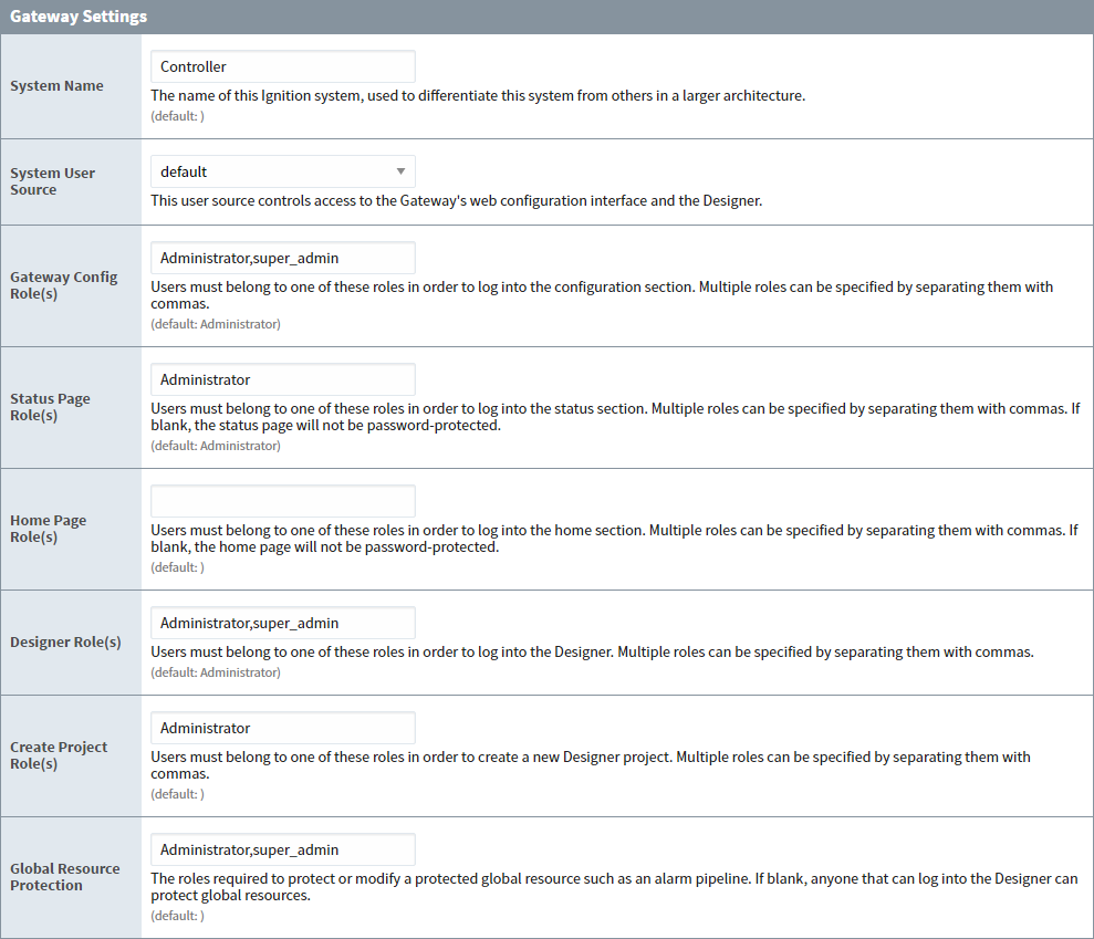

You can set up security for the Gateway webpage sections and the Designer. The Gateway can use any existing authentication profile independent of any projects. Each of the Status, Home, and Configure pages can be restricted by role. Outside of logging into a Client, the Designer as well can require a special role.
Here is where you should start thinking about your security policy. Roles play an important part. Roles allow you to provide access to different areas of the Gateway (and project). We recommend that you create separate roles for the Gateway Configure Page, Status Page, Home Page, and Designer so that individual users only have access to specified areas where they will be working.
To Setup Security for the Gateway​
  1. Go to the Configure section of the Gateway.
  2. Choose System > Gateway Settings from the menu on the left.
    The Gateway Settings page is displayed.
  3. Enter the roles the user must have in order to access the Gateway Config Roles, Status Page Roles, Home Page Roles, and Designer Roles.
    Each option can accept any number of roles as long as they are separated by commas. Also, if the option is blank, any user can log in. The Global Resource Protection will shelter the Global Resources (like Alarm Pipelines or SFCs) from edits by users without a matching role.
