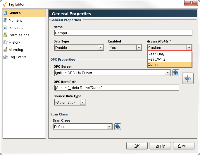

  1. In the Tag Browser, edit a Tag by double-clicking on the Tag.
  2. In the General tab, from the Access Rights drop-down, select Custom.

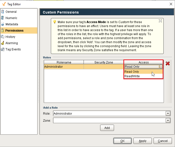

  3. Select the Permissions tab on the left side, and from the Add a Role drop-down select a role. Click the Add button.
  4. Change each role's Access rights by selecting the Read Only or Read/Write option. If a user does not have any of the listed roles, they will be denied both read and write permissions.
  5. Click OK. Now the user has the Read/Write permission to interact with the Tag.

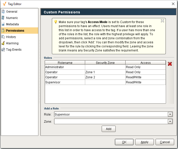

Tag Access Rights with Security Zones​
Tag permissions can also include Security Zones. Security Zones allow you to not only limit Tags by a user's role, but also by area. They are setup in the same way as setting the Access Rights just for a user, except a zone must also be specified. It does require that Security Zones be configured, and a few Gateways connected in a Gateway Network. Leaving the Security Zone empty will assume the access permission is for all zones.
