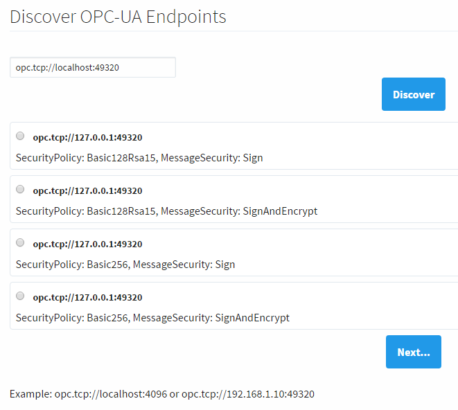

  4. On the Discover OPC-UA Endpoints page, type in the endpoint of the OPC-UA server Ignition should connect to. The format should be as follows:
opc.tcp://IpAddress:Port
#Examples
#If KepServer is installed on the same server as Ignition and uses the default port,
#the following endpoint could be used:
opc.tcp://localhost:49320
#If KepServer is installed on a different server from Ignition, then the IP address would be used:
opc.tcp://10.1.1.10:49320
Once an endpoint has been entered, click the Discover button. A list of available Security Policies and Message Security options will appear.
  1. Select a Security Policy and Message Security configuration to use when connecting to the endpoint. Both Basic256 and SignAndEncrypt offer a higher level of security.
Once an endpoint configuration has been selected, click the Next button.
