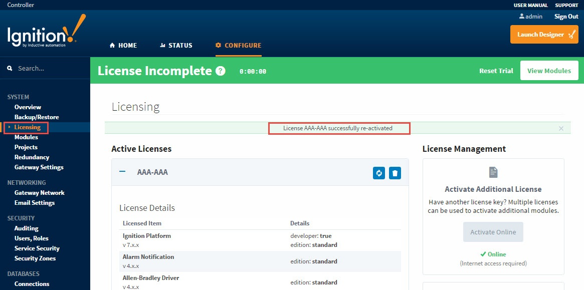

With an Internet Connection​
With an internet connection, do the following steps to update and reload your license:
  1. Go to Configure section in the Gateway webpage.
  2. Click on System > Licensing. The Current License is displayed. Click the Update License icon.
  1. The Licensing page will appear and you'll notice a status message stating that the your license is updating. This connects your machine to the Ignition licensing server. The licensing server verifies your license to be valid then updates your license. You will see new modules, if you purchased any, and new versions for the modules you already have. Once the update is complete, you'll notice a status message that your 'License is successfully re-activated,' and will display a list of all your licensed modules. You can also click on View Modules to see which module is in Activated, Trial or Free mode.

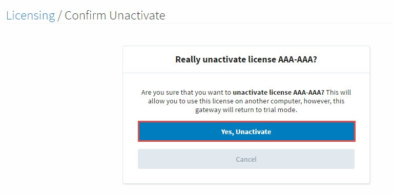

Without an Internet Connection​
If you do not have an internet connection and want to reload or update your license, you must unactivate, and then manually activate Ignition.
  3. Click the Unactivate License icon " " to the right of your license.
  4. The Licensing / Confirm Unactivate window will appear. Click Yes, Unactivate. Ignition will attempt to unactivate automatically, but if it cannot, a new page will open with instructions for manual Unactivation. Follow the steps there. This will include downloading an unactivation file and taking it to another computer that has an internet connection. Have a thumb drive handy to transfer files if you can't send them directly to another computer.

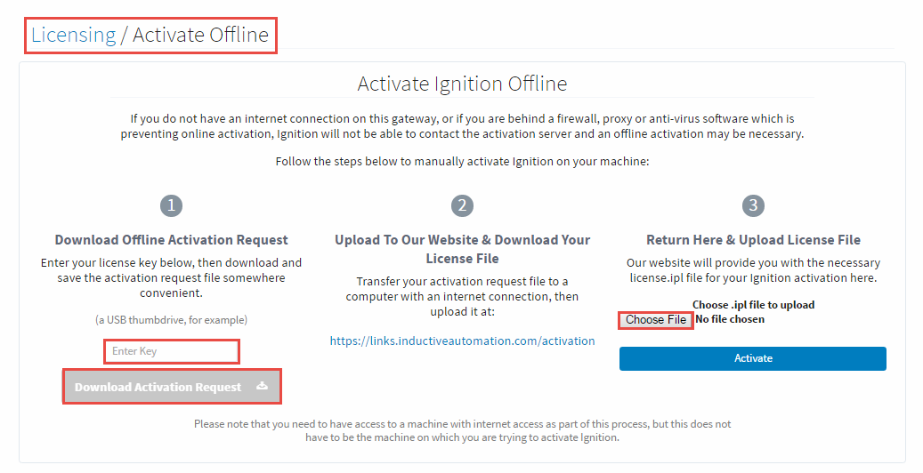

  1. The Licensing page will appear. Click Activate Offline
  1. The Licensing / Activate Offline window will open. Follow these three steps for activating your license offline.
With any new activation, all updates to the license will be automatically applied. For more help activating Ignition manually, see the Offline Activation section.​
