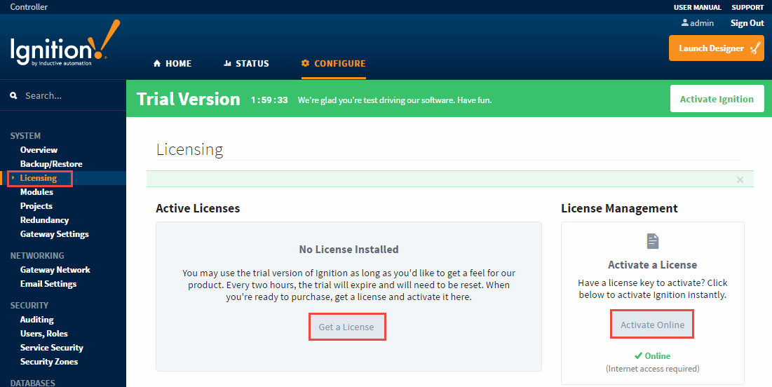

  2. From the menu on the left, select System > Licensing. The Licensing page will appear. If you already have a license key, click the Activate Online button. If you want to use the Trial Version of Ignition, click Get a License.

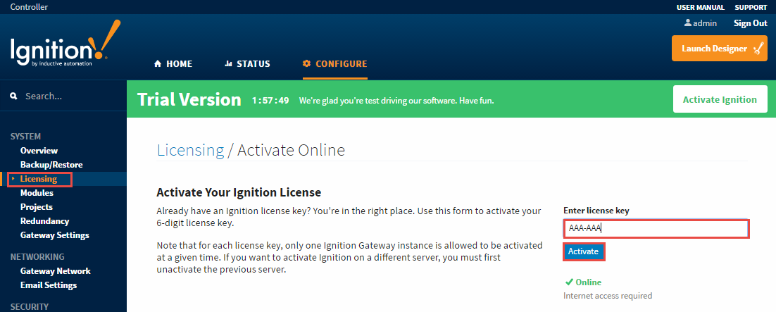

  1. The (Licensing / Activate Online) page will be displayed. Enter your License Key and click Activate.

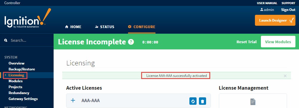

The Licensing page will refresh and your Current License will be successfully activated.

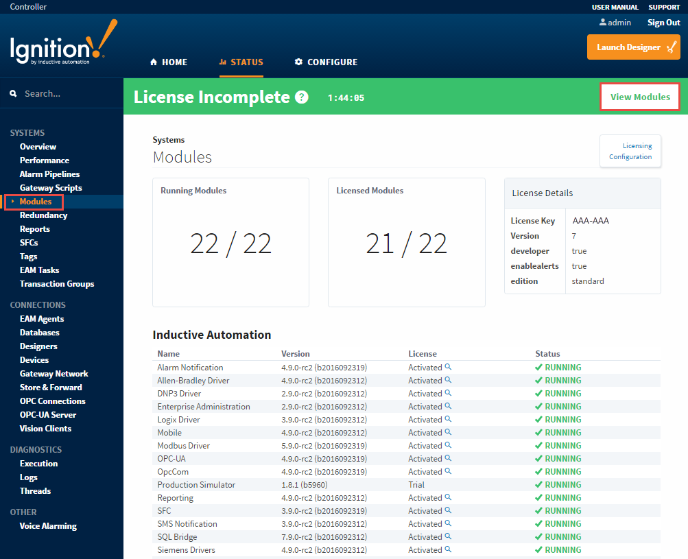

  1. To view the your system modules, click View Modules. The list of all your modules will be displayed along with their version number, license, and status. Note: Don't be alarmed by the License Incomplete message on the green banner. Click on the question mark " ". It opens an informational message box stating the current license does not include all of the modules that are installed. Some of the modules are in Trial Mode.

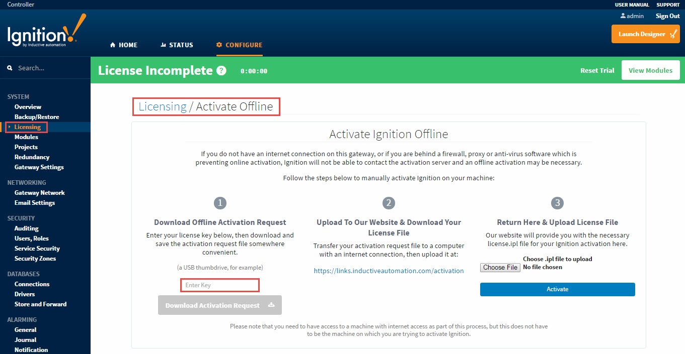

  1. The Licensing / Activate Offline page will be displayed describing how you can activate manually. Enter your license and press Download Activation Request. An activation request file, called activation_message.txt is generated and downloaded.
