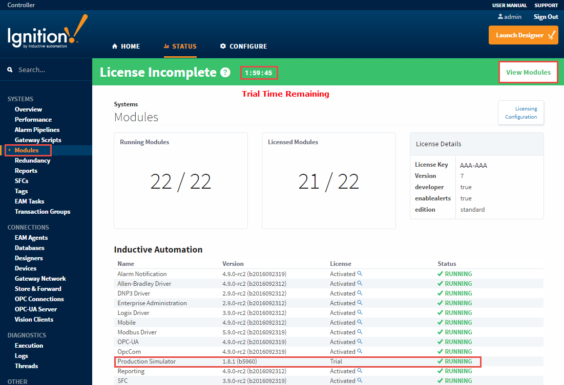

Trial Timer When Licensed​
After a license has been applied, you will still see the Trial timer display the time remaining. To check which modules are running in Trial Mode, click View Modules on the green bar at the top of the page.
This means that some of the modules are in Trial, while others are activated by the license. Only the modules that are unlicensed will time out when the Trial period ends. All other modules will continue working normally. Because the Trial can run on a licensed Gateway, you can freely try new modules by simply uploading them to the Gateway. This is a great way to check out a module before purchasing.
If you see the Trial timer when you think you shouldn't, go check the Modules page in the Configure section. In most cases, an unlicensed module was included in the initial installation, or you have a module that is a newer version than your license allows.
