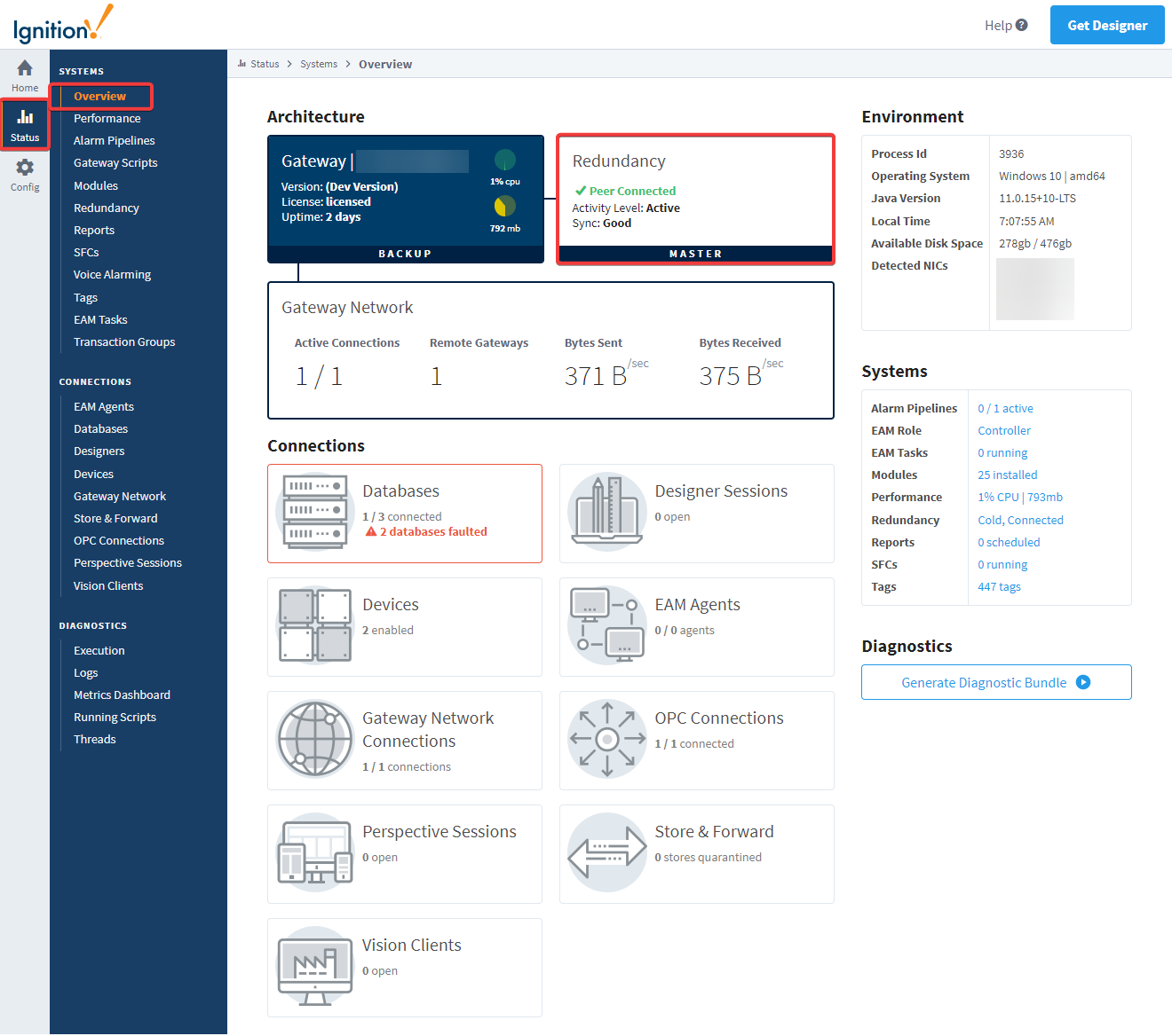

Ignition redundancy supports 2-node systems, this means there are two copies of the Ignition Gateway. One node (the Master Gateway) is considered the master node and the other (the Backup Gateway) is the backup node. Both nodes share the same state or configuration. In other words, all projects, Gateway settings, and so on are shared between the nodes. The master node manages the configuration then replicates it to the backup node.
When you have the redundant system in place, you can get detailed status information by going to the Status tab of the Gateway webpage as shown here and looking at the system's map:
