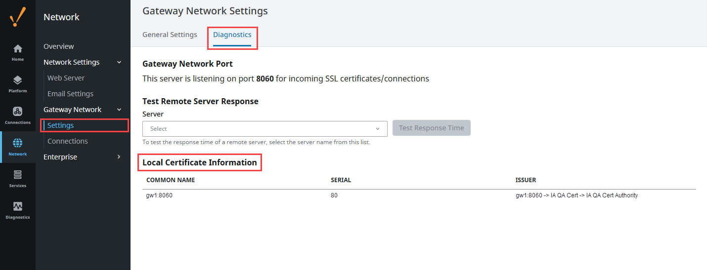

Once all certificates are signed and configuration is complete, you can restart your Gateway and then navigate to Network > Gateway Network > Settings to access the Diagnostics tab and confirm the local certificate information.
Local Certificate Information
