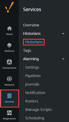

  1. Navigate to the Services > Historians > Historians section of the Gateway.
    Configuring a QuestDB Internal Historian Step 1

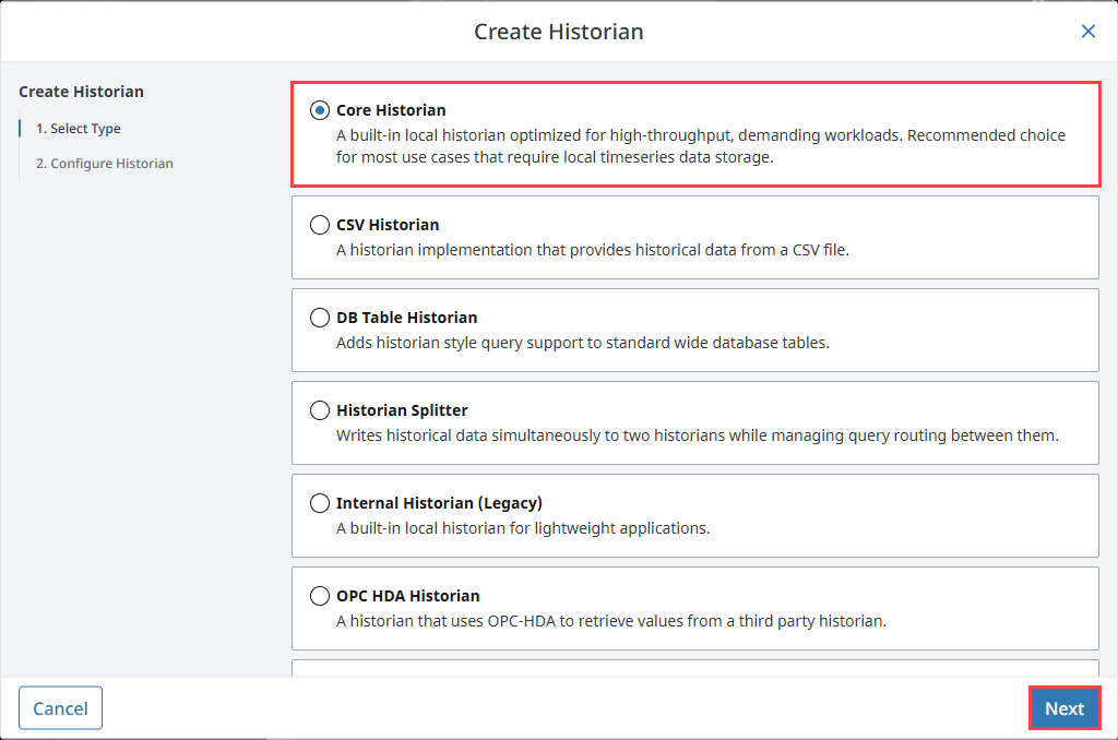

  3. From the Create Historian form, select Core Historian, then click Next.
    Configuring a QuestDB Internal Historian Step 3

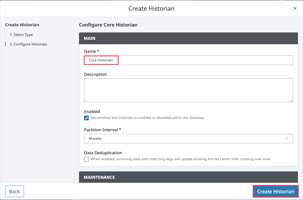

  4. Give your Historian an appropriate name, and configure the settings to align with your needs. In this example, we will name our Historian Core Historian, and leave the settings as the default. Click Create Historian when done.
    Configuring a QuestDB Internal Historian Step 4

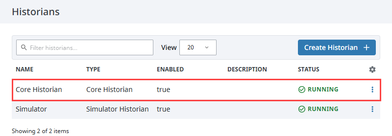

Your Core Historian will now be listed and ready to store data.
