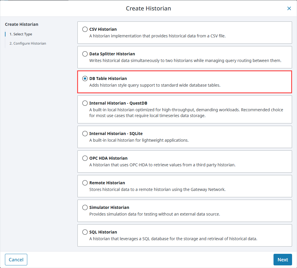

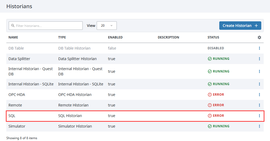

  1. On the Gateway, go to Services > Historians > Historians.
  2. Click Create Historian.
  3. Select DB Table Historian, then click Next.

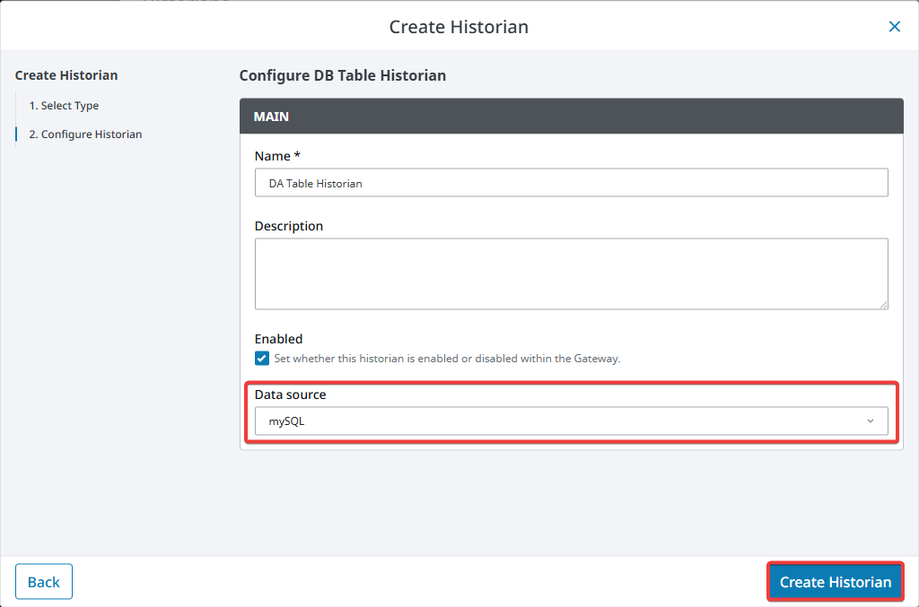

  4. Enter a name for the provider.
  5. In Data Source, select the database connection that contains the target tables.
  6. Click Create Historian.
