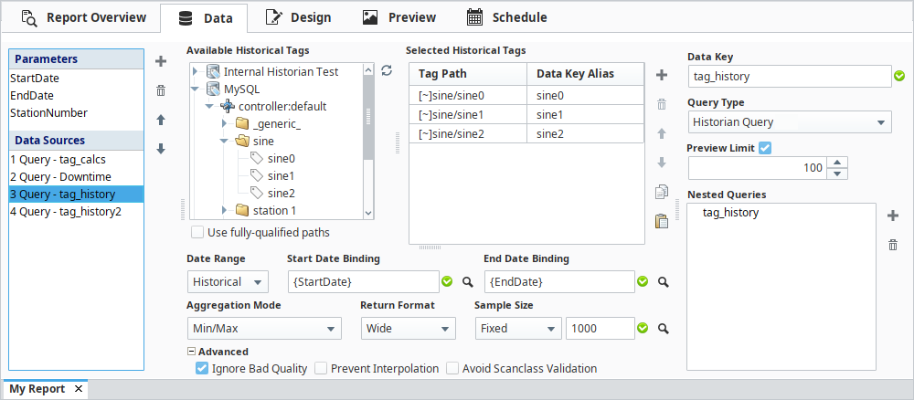

The Historian Query provides a simple way to query data from the Core Historian. In the Historian Query you can read data from Historical tags for specific date ranges, apply aggregates, and specify the sample size. It functions the same as a Tag History Binding and uses the same interface, so check out that page for more information on the individual properties.
Using Parameters in a Tag History Query​

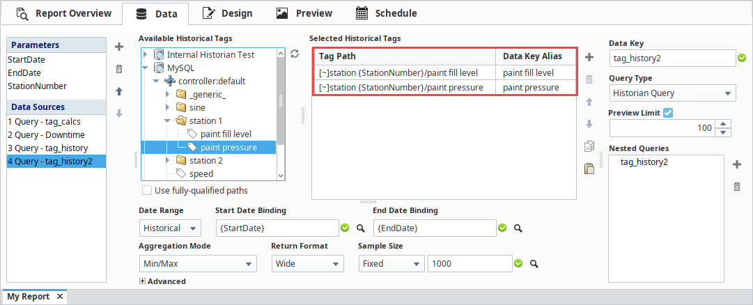

The only difference between a Tag History binding and the Historian Query is when using indirection. In the Historian Query, indirection is inserted directly into the tag path in the Selected Historical Tags section.
Assume we have a parameter named StationNumber:
Indirection is typically done using a parameter, which is the name of the parameter enclosed in . In the example below, the parameter StationNumber is inserted into the tag path in place of the station number. Note that you need to manually type out the name of the parameter, including exact spelling and capitalization.
Assuming base tag paths like the following:
[~]station 1/paint pressure
[~]station 1/paint fill level
we can replace the "1" with a reference to StationNumber:
[~]station {StationNumber}/paint pressure
[~]station {StationNumber}/paint fill level
Additionally, a Historian Query can accept more than one parameter in a tag path. For instance, if each station had different areas for paint pressure and paint fill level tags, you could reference the station area using the parameter Area.
If the base tag paths are as follows:
[~]station 1/east/paint pressure
[~]station 1/west/paint fill level
The station number "1" and "east"/"west" areas can be replaced with StationNumber and Area:
[~]station {StationNumber}/{Area}paint pressure
[~]station {StationNumber}/{Area}paint fill level
