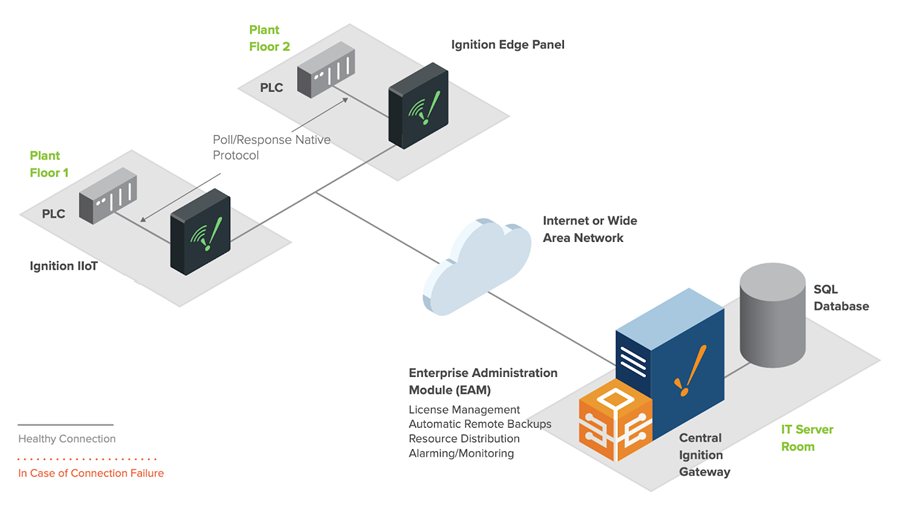

Each Edge product (Panel and IIoT) offers specific functionality that works best in certain scenarios. The diagrams show some architecture options using Edge. Additionally, these architecture diagrams show an Edge Gateway paired with an Ignition Gateway, which shows how an Edge system architecture can be added on to any of the other Ignition architectures.
Panel​
Edge with the Panel product can act as a stand-alone panel by simply connecting to a local PLC and building a basic screen. When paired with a central Ignition Gateway, the Edge can also act as a local client fallback, providing control on site in the event of a lost network connection.
Edge Panel Basic Architecture
Edge Panel with EAM

Edge EAM​
Edge EAM, also included with either the Edge IIoT or Panel product, acts as a remote EAM Agent Gateway and can easily combine with any other Edge edition for central management.
