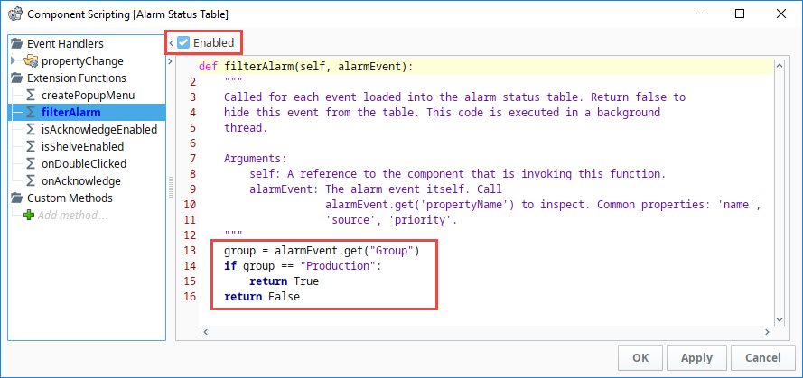

Next, create a script to filter for all alarms in the Alarm Status Table that have the associated data called ‘Production.’ Scripting allows you to use the 'filterAlarm' extension function specifically for filtering on associated data.
  1. Right click on your Alarm Status Table component, and scroll down and select Scripting.
  2. In the Component Scripting window, under Extension Functions, select 'filterAlarm.'
  3. Click the Enabled checkbox.
  4. Enter the code below into the 'filterAlarm' script. You can filter on anything you want here, but in this example, we are going to filter on 'Production.'
    Extension Function - filterAlarm for 'Production'
    group = alarmEvent.get("Group")
    if group == "Production":
    return True
    return False
    Your script will look like the image below. This script will only display alarms matching the associated data for 'Production.' For every alarm matching ‘Production,’ it will return ‘True’ and show alarm results in the Alarm Status Table. If the associated data does not match ‘Production,’ it will return ‘False,’ and the Alarm Status Table will be empty. Note, when you're finished filtering on associated data, don't forget to disable your script.
