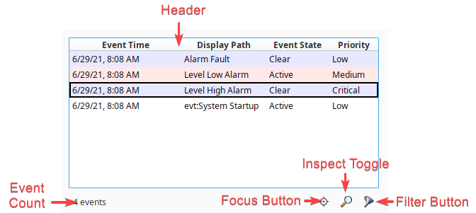

Interface Elements​
Element | Description |
Selecting an Event | Click on any event (row) in the table to select it. Some of the other interactions, such as the Inspect Toggle, require that an event is first selected. |
Header | Events in the Alarm Journal Table can be sorted by each column. Simply click on the desired column header to sort by that column. Columns can be reordered in the Vision Client by simply dragging and dropping them. In addition, right-clicking on the header will bring up a list of available columns to show or hide. ![]() |
Event Count | A count representing the number of events available in the table, accounting for filters applied to the table. |
Focus Button | Clicking this button while an event is selected will open a popup with the following to two selections: Target Alarm Source: Displays only alarms that match the selected alarm's Source Path. Target Event Id: Clears all alarms from the table, except those that have a matching value for the Event Id column. This is commonly used to show only the active, acknowledgement, and clear events for a single alarm, effectively allowing you to see the lifecycle of that alarm instance. Clicking on the Focus Button a second time will end focus filtering. |
Inspect Toggle | Clicking this button while an event is selected will open a popup that shows all alarm properties for the selected event. |
Filter Button | Clicking this button will call the Filter panel, allowing you to filter the results in the table based on event type, priority, or search string. |
