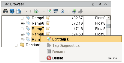

  1. In the Tag Browser, right-click on any Tag, and click Edit tag(s).
    The Tag Editor window is displayed.

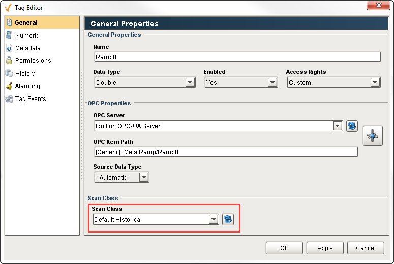

  2. On the General tab, choose a scan class from the Scan Class drop-down for the selected Tag.
    For example, choose the Default Historical scan class.
  3. Click OK to save it.
    You will immediately see the Tag updating at a different rate.

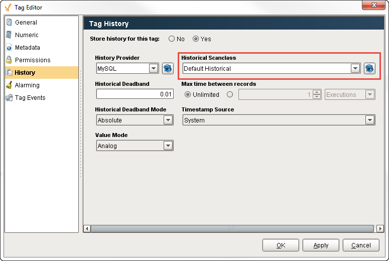

  4. The Tag also uses the scan class to determine how fast to log data for the Historian. The Historical Scan Class doesn't affect how fast the values get polled from the PLC, but affects how fast the data gets logged to a database. On the History tab, you can set the Historical Scan Class to Default Historical.
