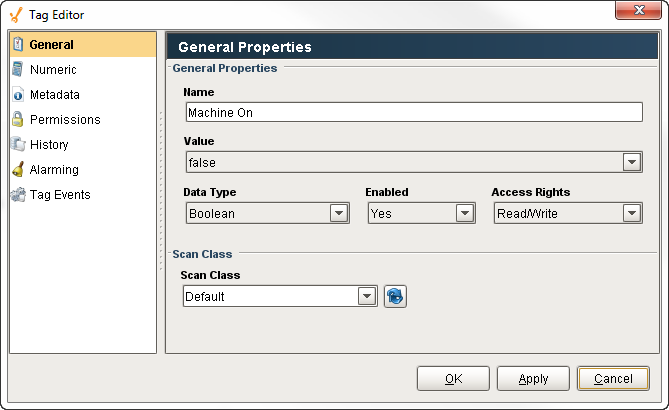

  1. In the Tag Browser, right-click on the Tags folder, then go to New Tag > Memory Tag to create a memory Tag. The Tag Editor window is displayed.
  2. In Tag Editor, enter the following:
    • Name: Machine On
    • Value: false
    • Data Type: Boolean
  3. Click OK to add the Machine On Tag to the Tag Browser.

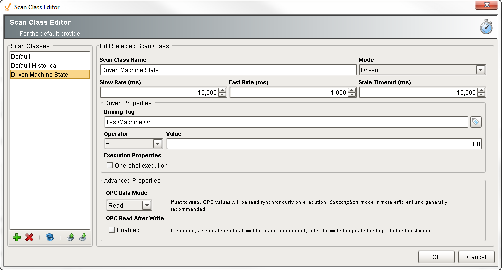

Once you have your driving Tag created, add a Driven scan class that updates the Tags based on when the machine is ON.

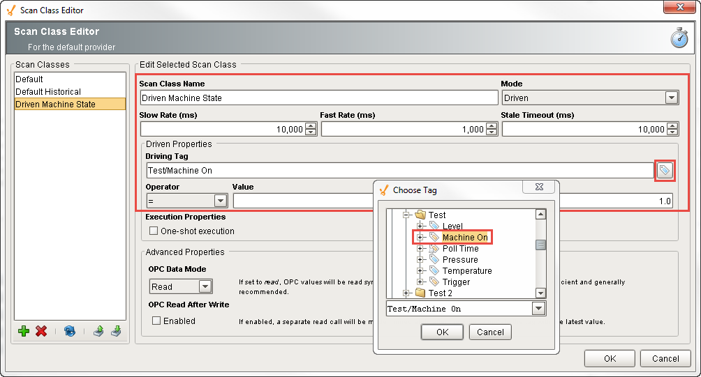

  1. In the Tag Browser, click on the Timer icon (" ") to open the Scan Class Editor.
  2. To create a new scan class, click on the green + icon on the lower-left of the window.
  3. Enter the name of the scan class. For example, you can name it Driven Machine State, and set the Mode to Driven. This scan class executes based on the condition you set on the Driving Tag.
  4. Click on the Tag icon next to the Driving Tag box, and choose the Tag you want to set the condition on, and click OK on the popup. This example uses the Machine On Tag that was just created.
  5. Set the Slow Rate to 10,000 (10 seconds) and the Fast Rate to 1000 (1 second).
  6. Set the Operator property to = and the Value property to 1. When the machine is ON it will use the Fast Rate, and when the machine is OFF it will use the Slow Rate. Click OK on the Scan Class Editor window.

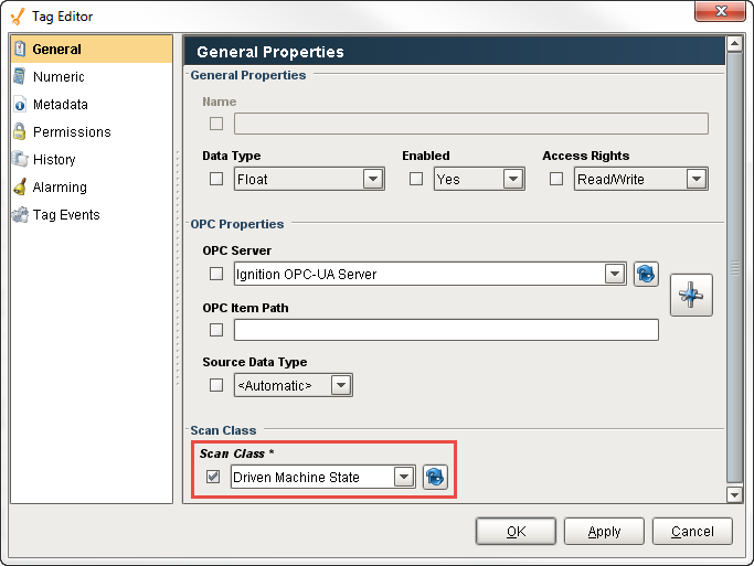

  7. Next, select all the other Tags that you want to use the scan class for (i.e., Level, Pressure, and Temperature). Right click on one of the selected Tags and choose Edit Tags. To change the scan class, choose our new Driven Machine State from the Scan Class dropdown, and click OK.
  8. In the Tag Browser, mark the checkbox next to the Tag (i.e., Machine ON), that you created to turn the machine ON. Now, when the machine is ON, polling will be a at the 1 second rate. When the machine is OFF, polling will be at the 10 second rate. Test it by toggling the Machine Tag ON and OFF.

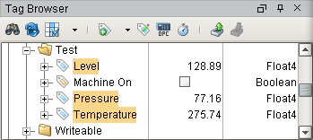

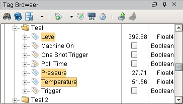

    You can also set the Slow Rate or the Fast Rate to a value of 0, which means polling is stopped when the condition is false. So for example, when the machine is OFF, you will see the Tags stay at the last known value, and a overlay will appear on the affected Tags.
    Once the machine is turned back ON, the Tag overlays disappear. The overlay will only appear on the affected Tags one time, and that is when the slow or fast polling rate was run for the first time after initially being set to a value of 0.

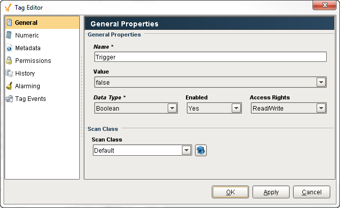

In order to get the trigger from Ignition, you need to create a driving Tag.
    • Name: Trigger
    • Value: false
  3. Click OK to add the Trigger Tag to the Tag Browser.

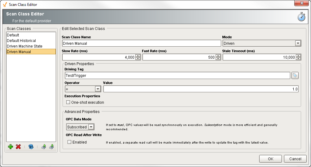

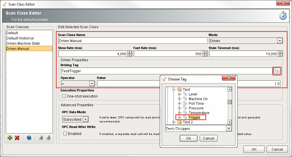

  2. Create a new scan class, by clicking on the green + icon on the lower-left of the window
  3. Name the scan class, for example, you can name it Driven Manual, and set the Mode to Driven. This scan class executes based on the condition you set on the Driving Tag.
  4. Click on the Tag icon next to the Driving Tag box, and select the Tag you want to set the condition on, and click OK. This example uses the Trigger Tag that was just created. Click OK.
  5. Set the Slow Rate to 4000 (4 seconds) and the Fast Rate to 500 (1/2 second, a very fast rate).
  6. Set Operator property to = and the Value property to 1. When the Trigger is equal to 1 it will use the Fast Rate, and when the Trigger is equal to 0 it will use the Slow Rate. Click OK.

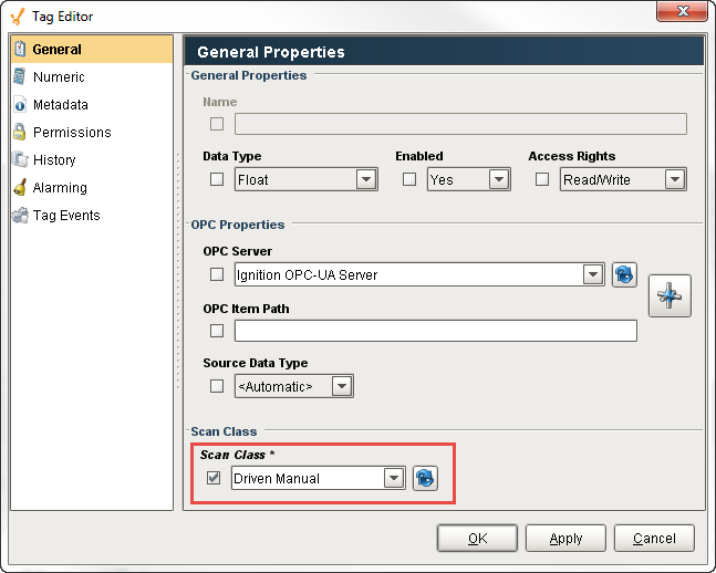

  7. Next, select all the other Tags that you want to specify in the scan class (i.e., Level, Pressure, and Temperature). Right click on the selected Tags, and the Tag Editor will open. To change the scan class, choose Driven Manual from the dropdown, and click OK.
  8. Now, in the Tag Browser you will see a checkbox next to the Trigger Tag which you can set the ON/OFF condition. So when the Trigger is set to ON, you are going to run at the Fast Rate of 500 ms. If the Trigger is set to OFF, it will run at the Slow Rate of 4000 ms.

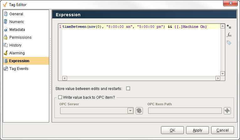

Let's use an Expression Tag to drive the condition. You can use the functions that are in the expression language to poll the PLC during the hours of 8am to 5pm, and if the machine is ON. In this example, both of these conditions must be true for the value to poll. This example assumes you already have a Machine On boolean Tag in the same folder.
  1. In the Tag Browser, create an Expression Tag that is a Boolean. Right click on the Tag folder then go to New Tag > Expression. The Tag Editor window is displayed.
    Enter the following:
    • Name: Poll Time
    • Value: false
  2. Click on Expression from the menu on the left, and enter the expression below. The condition is true when the time is between 8am and 5pm, and the machine is ON, otherwise it is false at other times, and/or when the machine is OFF. Click OK.
    timeBetween and Machine On expression
    timeBetween(now(0), "8:00:00 am", "5:00:00 pm") && {[.]Machine On}

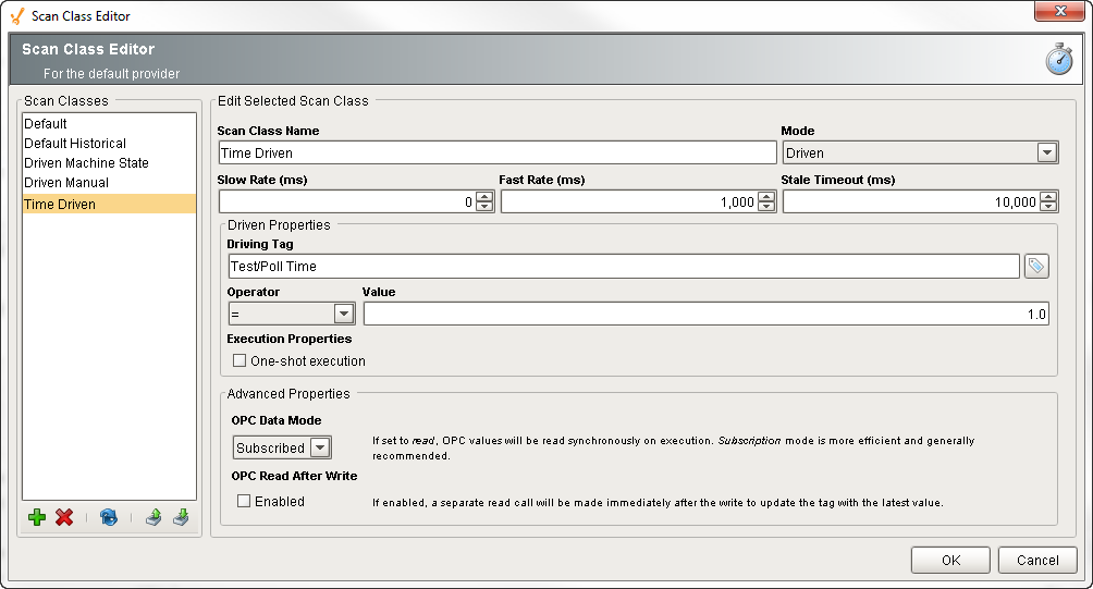

To Add a Driven Scan Class based on the Time of Day​
Now that you have your Poll Time Tag created, add a Driven scan class that updates the Tags based on a time of day and when the machine is ON using the expression.

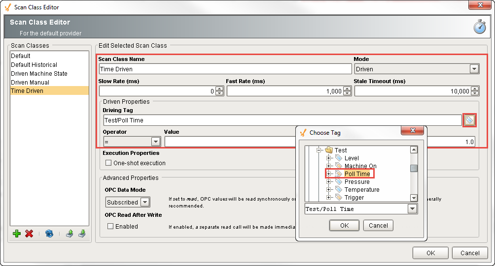

  3. Enter the scan class name to Time Driven, and set the Mode to Driven. This scan class executes based on the condition of the Driving Tag.

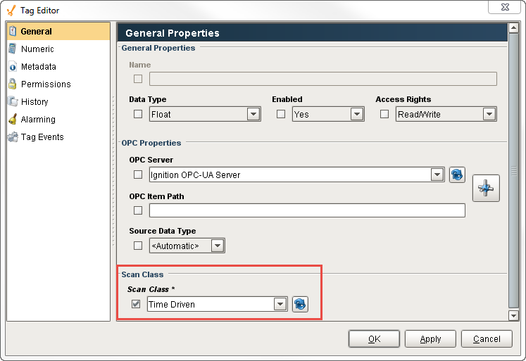

  4. Click on the Tag icon next to the Driving Tag box, and select the Tag you want to set the condition on, and click OK. This example uses the Poll Time Tag that was just created.
  5. Set the Slow Rate to 0 so you don't poll the condition when it is false. Set the Fast Rate to 1000ms.
  6. Set the Operator property to = and the Value property to 1.0. Click OK.
  7. Next, select all the other Tags that you want to specify in the scan class (i.e., Level, Pressure and Temperature). Make sure you don't select the Machine On Tag since it is helping to drive the Scan Class. Right click on the selected Tags, and the Tag Editor will open. To change the scan class, choose Time Driven from the dropdown, and click OK.

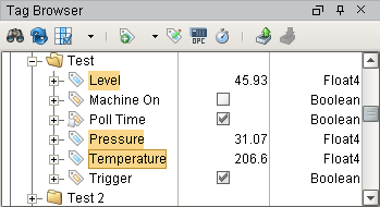

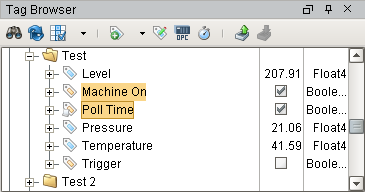

  8. In the Tag Browser you will see checkboxes next to the Poll Time and Machine On Tags. When the driving conditions are true, that is the time between hours of 8am and 5pm, and when the machine is ON, polling is at the Fast Rate of 1000 ms. When both conditions are false, polling is stopped, and the last known value is displayed.
