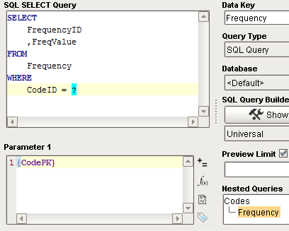

We want to create a data source connecting all these things for reporting using nesting. The trick is to identify where the two datasources connect. You may notice in the data above The CodePK column in the Codes datasource matches up with the CodeID column of the Frequency datasource. This is where we will connect the two datasources. We will make our Codes datasource the parent and the Frequency the child. The queries would look something like below.
-- Parent Query
SELECT CodePK, Code FROM Codes
-- In the Child Query, accessed by clicking on the Frequency leaf of the Nested Queries Tree
-- This assumes the value of Parameter 1 would be equal to {CodePK}
SELECT FrequencyID, FreqValue FROM Frequency WHERE CodeID = ?
What this means for our resulting data is that the parent query is called first, and a set of results is returned to the parent query, named Codes. After this data has been retrieved, the Child query will execute, once for each row of the parent, substituting the value of CodePK into the child query where we have the {CodePK} reference.

Each row returns the CodePK and Code from the parent query, but also the results of the child query, that apply to the CodeID we get from the parent PK.
Now, in our Report Design, we will have access to our datasource Frequency that linked these two sets of data together through a shared value.
