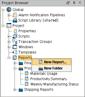

The Reporting interface was designed with the same look and feel as the Vision Module. Once you install the Report Module, you'll be able to open the Ignition Designer and see a Reports resource folder. Since Reports are a Project-Level Resource, it's easy to create a new report whether it's used in a window or not. With a right-click on the Reports node in the Project Browser and the option to create a new report is a click away.

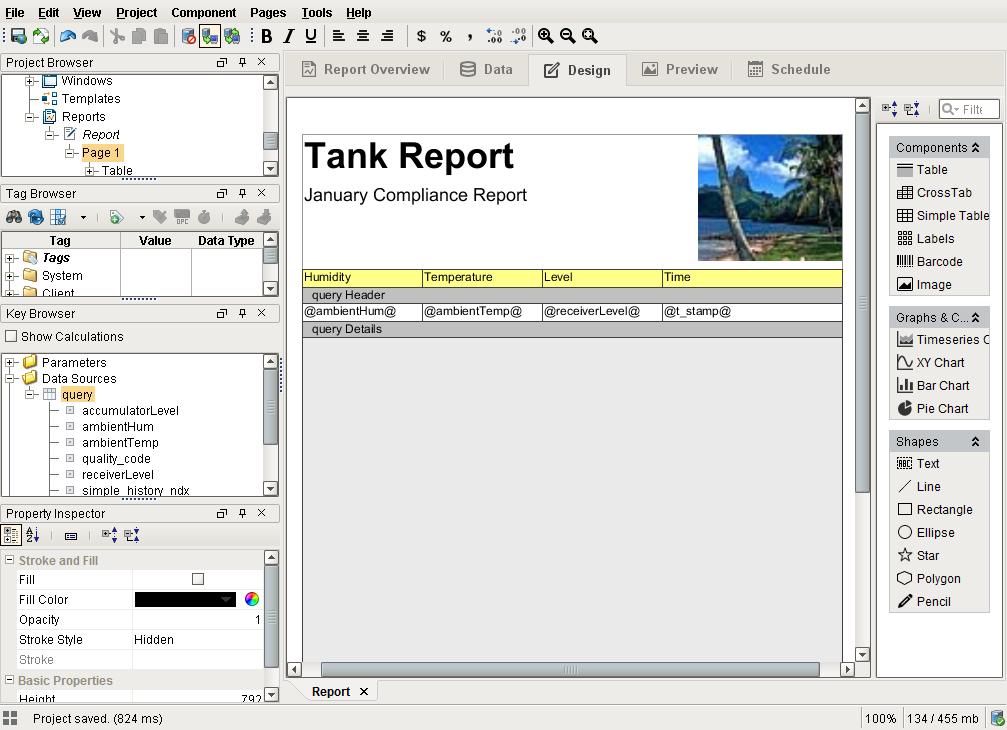

From the first informative panel to full previews of the report you are creating, the Reports workflow will significantly cut the time it takes to design, edit, and distribute reports. We believe this Report workflow will be understandable to the new developer, yet powerful enough for a seasoned analyst. Make no mistake, reports have a lot of moving parts, but fear not, you'll be able to leverage these tools to create impressive reports faster than ever!
