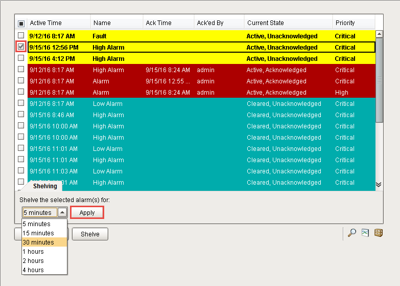

To shelve an alarm, select one alarm or multiple alarms, then press the Shelve button. The Shelving tab will automatically open so you can set a duration to silence an alarm You can set a duration from 5 minutes to 4 hours in which to shelve selected alarm(s). Select an alarm, choose 30 minutes, and press Apply. You can test out your shelved alarm in the Designer in Preview Mode.
How to Shelve an Alarm for 30 Minutes

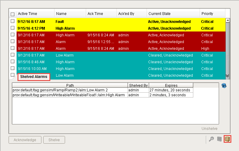

To view all the alarms that are currently shelved, go to the bottom right of the Alarm Status Table and click on the Shelved Alarms icon Shelved Alarm Icon. A Shelved Alarm tab will open and show all of the shelved alarms, as well as when the shelved time period expires. To close the Shelved Alarm tab, click either the Shelved Alarm icon or the Expand button Expand Button.
After the amount of time expires on a shelved alarm, it will be evaluated, and if it is still active, it will automatically return to the Alarm Status list. If the alarm transitions to a cleared state during the time shelved period (i.e., tank water level is low and when the water level returns to the setpoint), the alarm will show up as 'Cleared' in the Alarm Status list instead of 'Active'.
Alarm Status Table Shelved Alarms

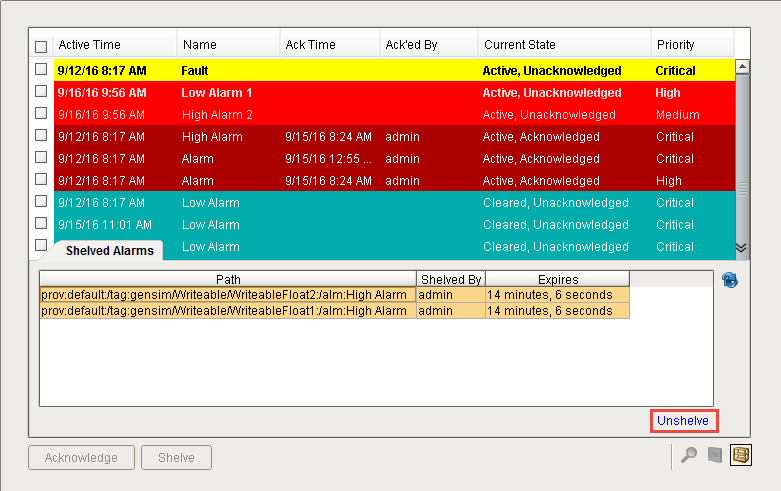

To unshelve an alarm, select the alarm(s) under the Shelved Alarms tab, click the Unshelved link, and the alarm will return back to the Alarm Status list.
How to Shelve an Alarm: Unshelf Alarm

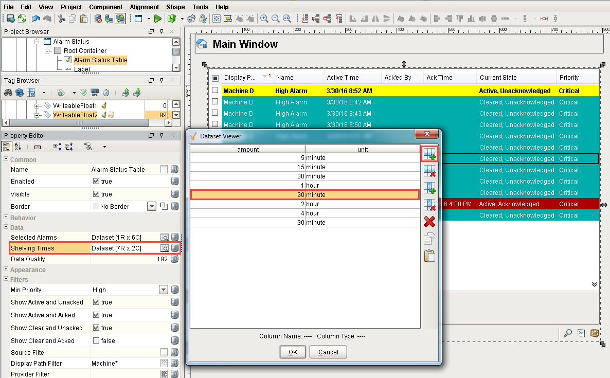

In the Property Editor, there is a property called Shelving Times. This is where you can add, remove, or change the shelving times for alarms.

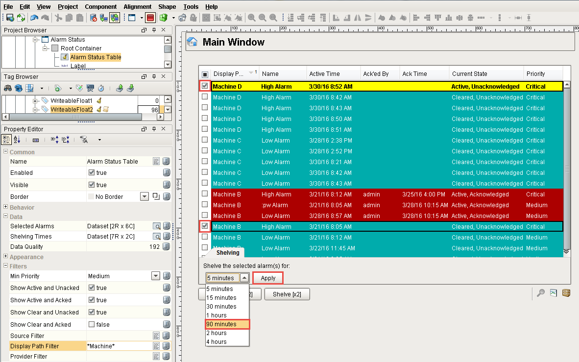

  1. In the Designer, select the Alarm Status Table component, and click on the DatasetViewer icon to open the Dataset Viewer.
  2. Click the green plus row icon Green Plus Row Icon to insert a new row. Enter the hour and the unit of time.
  3. Press OK. In this example, you can see that 90 minutes was added to the list of shelving times.
Custom Shelving Duration Dataset Viewer
To verify your new time was entered correctly, select the alarm(s) you want to shelve and click the Shelve button. Choose the shelve time from the dropdown list and press Apply to temporarily silence your alarm(s). You can see how easy it is to modify your shelved times.
