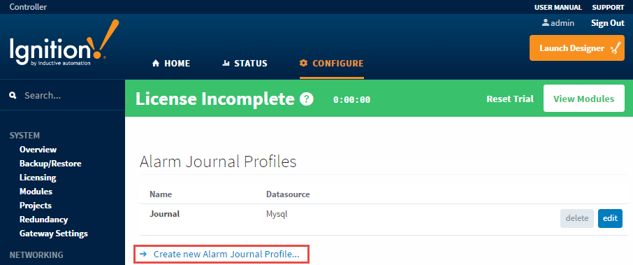

Go to the Configure section of the Gateway.
Choose Alarming > Journal from the menu on the left. The Alarm Journal Profiles page is displayed.
Look for the blue arrow and click on Create new Alarm Journal Profile.... The New Alarm Journal Profiles page is displayed.

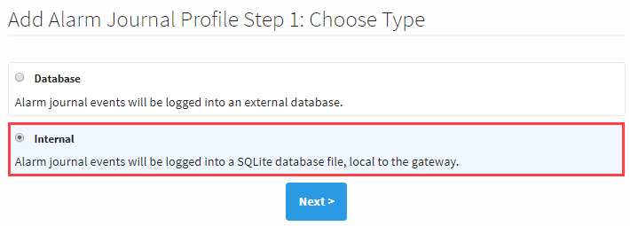

- New in 7.9.13Ignition Gateways can now create an Internal Alarm Journal Profile, which stores journal entries in the Gateway's internal database as well as an external SQL database. You can store alarm_events_data and alarm_events in the SQLite table.
To create an Internal Alarm Journal Profile, select Internal as shown in the image below. Click Next.
Fill in the fields and click the Create New Alarm Journal Profile button at the bottom of the page. Once completed, the tables will be created for you once an alarm event occurs. It’s a good idea to trigger a test alarm and verify that Ignition automatically created the tables in the database after your Alarm Journal Profile was created.

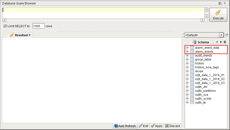

Verify the Alarm Journal tables were created.
You can easily verify the Alarm Journal tables from the Ignition Designer. Open it and go to the menu bar and select Tools > Database Query Browser.

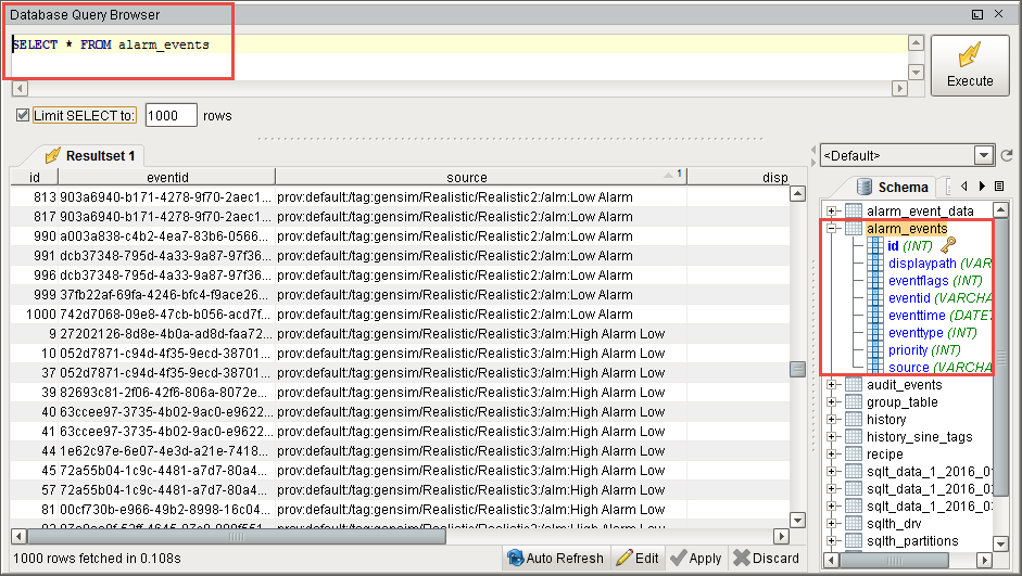

The two tables that Ignition automatically creates are the alarm_events and alarm_event_data. Alarm events consist of two main types of data: the primary information about the alarm, such as transition state, time, etc., and the event data. If you don’t see these two tables in your database, you need to make an alarm occur after the Alarm Journal Profile is created. Make the alarm Active, take it back to Clear, Acknowledge it, and you will start seeing information come into these tables.
Double click on the alarm_events, to see all the events that occurred when the alarms are Active, Cleared, and Acknowledged.

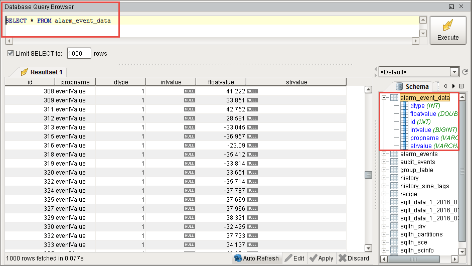

The alarm_event_data is all the associated data that is associated with each alarm.
You will want to look into the Database Query Browser to simply verify that the information is there. Once the information is there, close the Database Query Browser.
